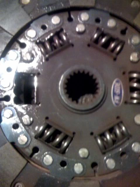

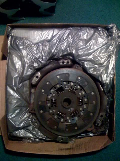

What happened to my SPEC Stage 2 Clutch was that a spring from the disc popped out so there was constant contact between the disc and the pressure plate so whenever i pressed on the clutch pedal it wouldn't disengage. Ended up getting a new clutch after all... Keep us posted i'll post pics of my clutch later tonight.

Yep I went back to "stock" clutch not OEM Toyota but it sure ass hell was OEM feel... Really really REALLY soft! took me a while to adjust from a really solid clutch like SPEC to the OEM feel one. NE ways... heres the pics i promised
The missing spring should be obvious...

Postby DatSRBoi » Sat Jan 26, 2008 9:31 pm
They did not warrant that? Looks like bad quality piece there.
Postby Jakecallun20 » Sat Jan 26, 2008 11:49 pm
DatSRBoi wrote:They did not warrant that? Looks like bad quality piece there.
That ought to be covered, I'd call and find out. Maybe you can get some if not all of your money back. When it comes to clutches, IMO, I prefer the OEM clutch. Simply because it is easier to drive (for me at least since I don't drive standard everyday) and it will generally last longer. Just my 2 cents
