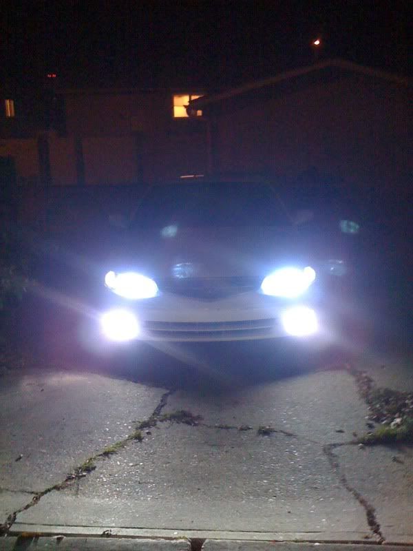

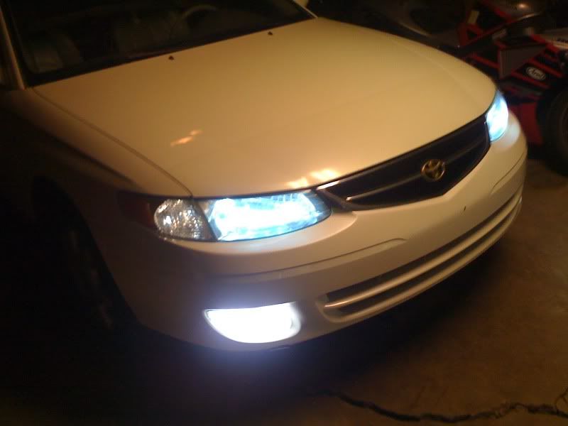

Postby kwan » Sat Nov 07, 2009 4:12 pm
hey guys thanks for help it worked out with the hids in the fogs, i got some pics but they are from my crappy iphone but ill get updated pics later. :drinking: thanks again for your time

Postby 99TOYs » Thu Mar 04, 2010 11:14 pm
what color ('K') are your headlights and fogs? look great!

Postby kwan » Mon Mar 15, 2010 1:28 am
12000k beamers for lowbeam
6000k eagles for fog lights

Postby Mole » Mon Mar 15, 2010 1:31 am
12k K should be "black light" color.
looks more like 6k K and 4k K in the picture
