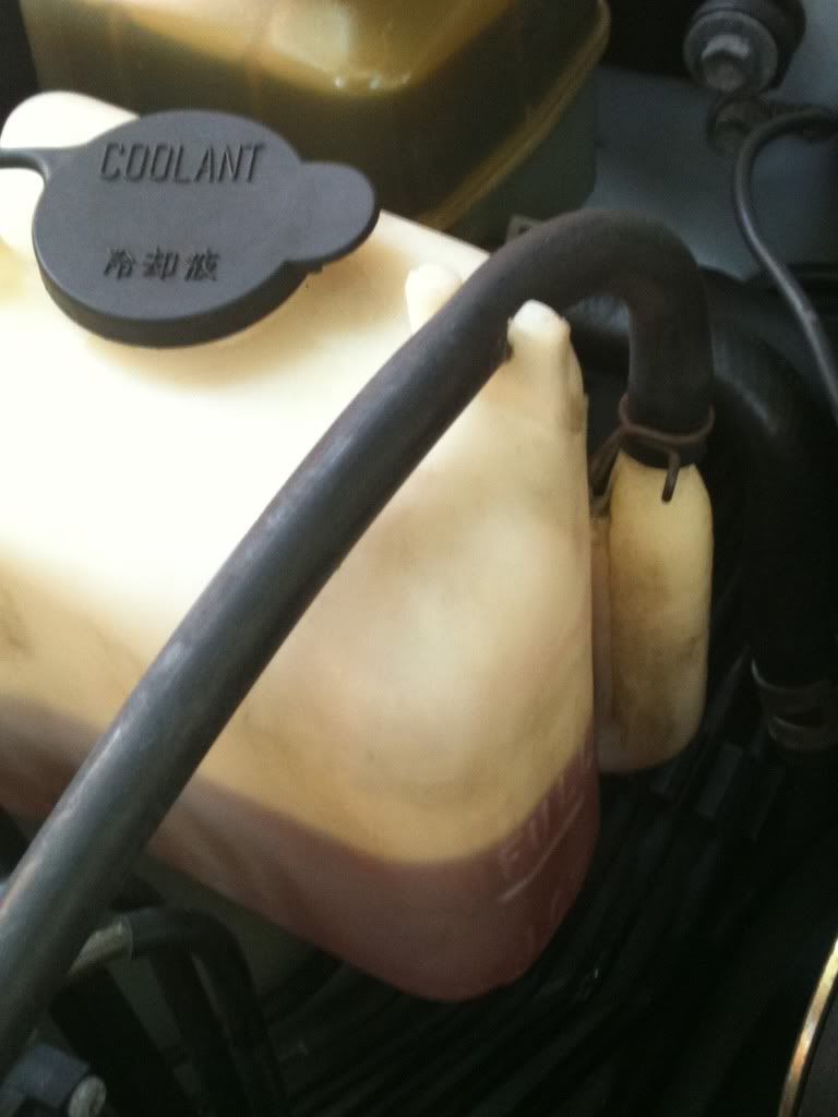

Postby bksolara » Mon Jul 26, 2010 10:42 pm
Image this is the toyota red coolant i own...

Re: coolant leak???
Postby bksolara » Tue Jul 27, 2010 10:27 am
i filled it up this morning i didnt use any distilled water because the guy at toyota said this one doesnt need water ill warm the car up later and see how the temperture looks on the dash thanks for the help

Re: coolant leak???
Postby 99BlackSandv6 » Tue Jul 27, 2010 12:50 pm
I guess the Toyota coolant is premixed then.
Why is that hose not connected? Or am I seeing things?
That should definitely be attached to the water neck.
Let us know what happens.

Re: coolant leak???
Postby 99BlackSandv6 » Tue Jul 27, 2010 4:12 pm
The water neck is where the upper radiator hose attaches on the engine.
That small hose should attach right below the radiator cap.
Do you have a v6 or a i4? That^ is for the v6.
If you have a i4, the radiator cap is on the radiator, and the hose should
attach in a similar location there.
Re: coolant leak???
Postby bksolara » Tue Jul 27, 2010 5:09 pm
I have a i4
bksolara
Posts: 112
Joined: Mon Sep 22, 2008 9:15 pm
Location: BROOKLYN NY
Re: coolant leak???
Postby 99BlackSandv6 » Tue Jul 27, 2010 10:02 pm
It's probably connected correctly then.
I was thinking that it was a v6, in which case
the hose would be routed differently.
False alarm! :lol:
