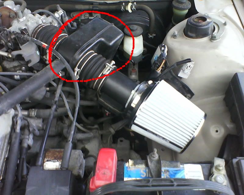

"GTX" - The thing in the red circle in your picture is the silencer.
Postby GTX » Sun Jul 12, 2009 3:27 pm
Thank you. Thats going away next. :-)

Postby Ilovemylara » Sun Jul 12, 2009 3:28 pm
GTX wrote:Thank you. Thats going away next. :-)
Where's your MAF sensor?
Postby aenties » Sun Jul 12, 2009 3:32 pm
The MAF sensor is there, instead of placing it on the side stock, he position it at the bottom. Shouldn't matter.

Postby GTX » Sun Jul 12, 2009 3:36 pm
What aenties said. I had to do some cutting and trimming but everything is there and works fine. I attached the vacuum hose to that same tube with the MAF.

Postby Ilovemylara » Sun Jul 12, 2009 5:16 pm
Oh I see it now. Awesome man! Remove that resonator, and you'll get alot more sound.

Postby GTX » Tue Jul 14, 2009 7:23 am
I still can't believe there were THREE silencers/resonators in this thing. The plastic jug, the airbox, and that black thing near the throttle body. Toyota REALLY didn't want anyone to hear the 1MZ, which is a shame because it sounds awesome. lol

Postby GTX » Tue Jul 14, 2009 8:22 am
I *might* do that later on. lol. Right now I'm trying to figure out what that hose that goes to the silencer I circled does and how I get it out. Then its off to Home Depot.

Postby Ilovemylara » Tue Jul 14, 2009 12:27 pm
That is the crankcase ventilation hose. it pulls gases out of the valve cover. You could relocate it to the tube you replace the resonater with.
