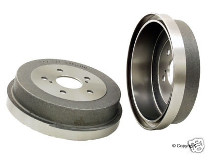

Postby ASG14 » Wed Apr 22, 2009 7:45 pm
^ NO! Drum and Disc brakes are DIFFERENT!
A drum brake is a drum brake and a disc is a disc.
If you have a caliper and pads, it's a disc.
If you have a Drum and shoe's, it;s a drum.
THAT SIMPLE!

Postby mazen222 » Thu Apr 23, 2009 5:42 am
ASG14 wrote:^ NO! Drum and Disc brakes are DIFFERENT!
THAT SIMPLE!
Again, my 99 Solara has both in the rear... discs with pads that produces ~25% of the braking power when pressing the foot pedal. Inside those discs are the shoes that are activated by the hand brake, the drum part is actually the inside of the discs.
exactly as in the second picture AG14 posted

Postby ASG14 » Thu Apr 23, 2009 8:28 am
THAT SIMPLE!
Sorry to tell you, it is STILL a disc brake, plain and simple. It's not a hard concept to grasp.
