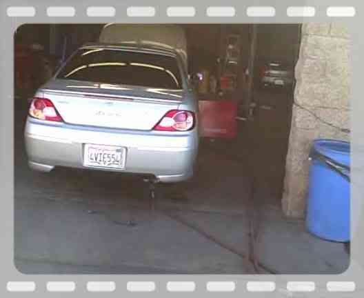

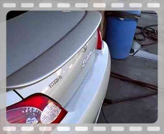

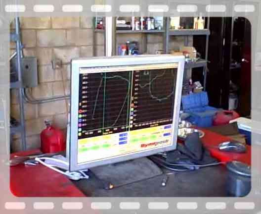

Image this is my 02 lara, befoe its broke in & after Image Image Image Image ................... :drinking:

Postby NRDriver » Tue Oct 20, 2009 6:33 pm
is this to the wheels?

Postby jetbtkng » Tue Oct 20, 2009 6:34 pm
yes................ :drinking:

Almost to 300, good job.
Is this boosting at 8psi? Did you upgrade the internals?

Postby Twin Turbo » Tue Oct 20, 2009 7:12 pm
290 is very impressive! Im also wondering if you did it with stock internals like pistons, camshfts, connecting rods, etc?

Postby jetbtkng » Tue Oct 20, 2009 7:40 pm
im running 8lbs boost, meth, cp forged pistons 9.5-1, dougs ported & polished heads & intake, running stock rods, and cams, i lowered the compression so i can run more boost, and i need to put bigger injectors, im using rc 325 injectors, i nieed 400.................. :drinking:
