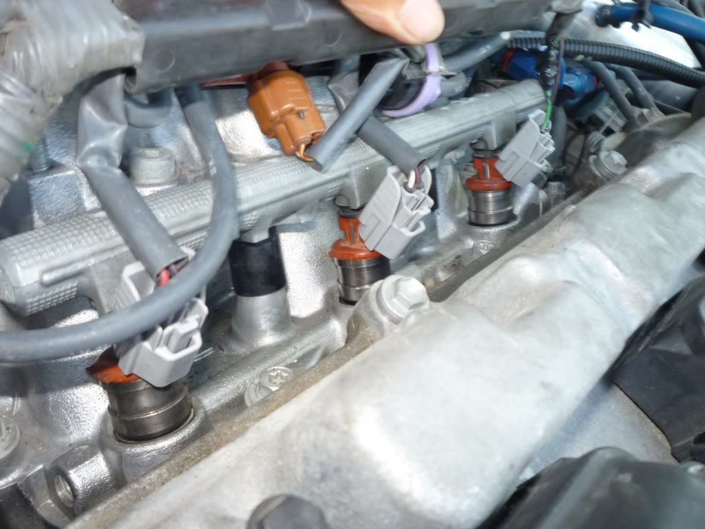

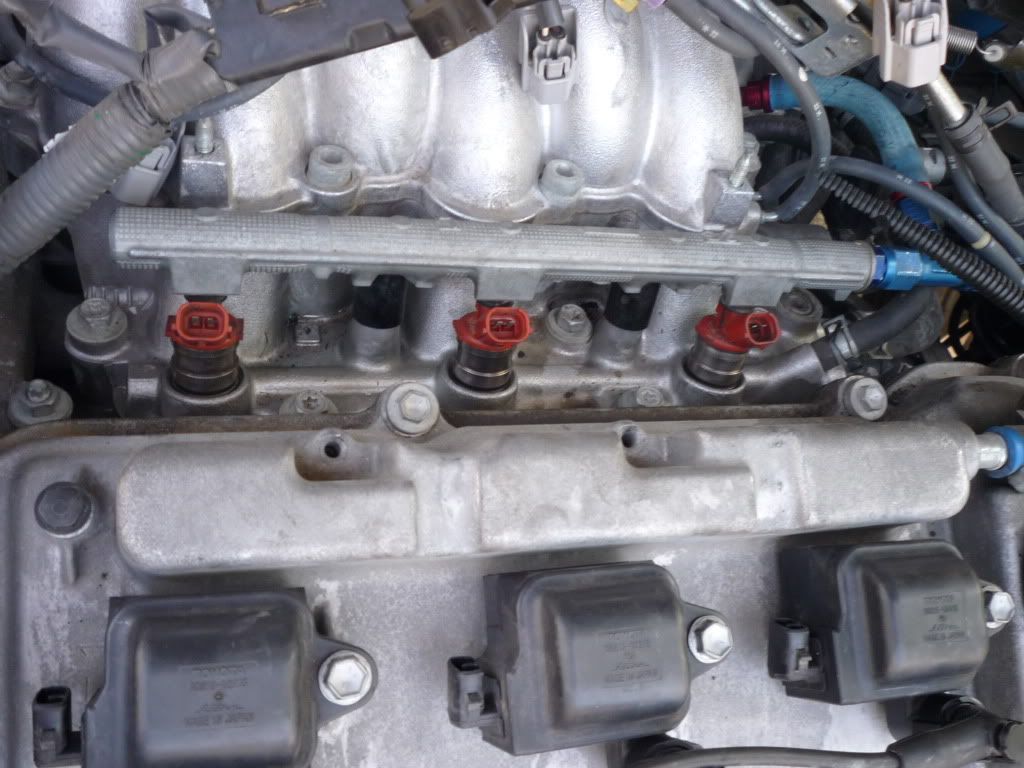

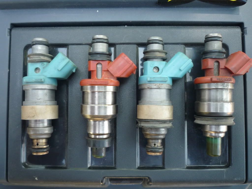

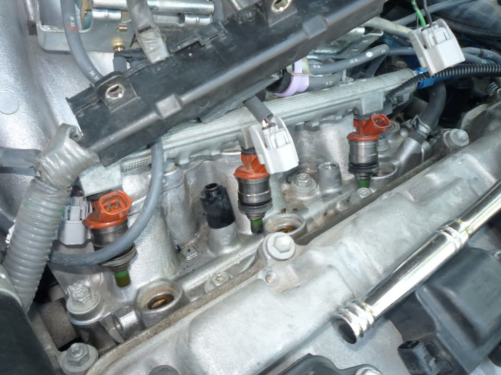

WOOT!! No need to spend $500+ on some RC's (not knocking them or anything) when you can pick these up for about 200 for 8. Keep in mind, these are from the 87 to 88 (maybe 88 to 89 i forget) NON TURBO RX7's (part number 195500-2010) These are 460cc...so once trd4life's M90 sc is out you can definitely have some fuel for them. The only downside is they aren't easy to find. They pop up on ebay every now and then. When they're installed the big o ring from the stock injector will work, and there's a spacer/grommet on the rx7 injector that needs to come off. Ok enough talking, here's the pix
Sorry Eye8pussies, i stole your idea from your injector thread :P
From left to right, stock injector w/o o-ring, stock rx7 injector w/ spacer, stock w/ o-ring, rx7 w/o spacer w/o o-ring
you sc'd guys better watch out :wink:
