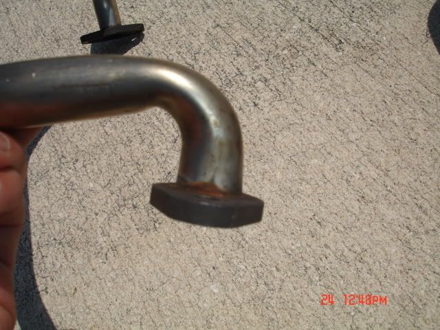

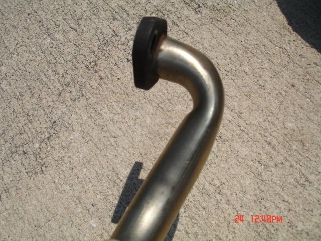

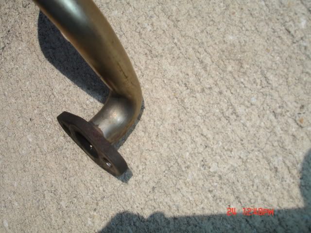

Postby 99V6solaraSE » Tue Mar 25, 2008 8:22 am
I think i know know why im getting the insufficient flow code. I guess when they fitted it on, they obviously had to bend it it slightly so its probably constricting the flow a little.
should i be concerned? I mean if its nothing serious then i can live with the CEL on.
