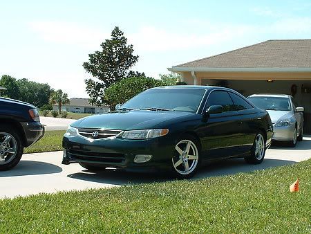

Postby Solarafreek » Fri Apr 18, 2008 6:50 pm
S-techs 5SFE :fadein:
