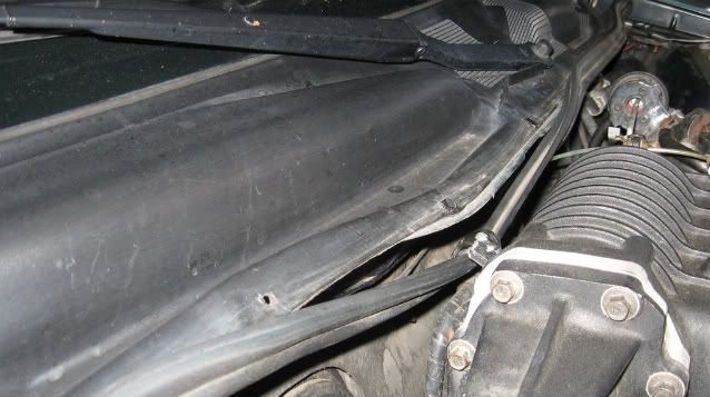

after taking some time to really look at it i noticed the S/C sits in possibly the worst part of the engine bay that it could. at the back and highest point near the fire wall as yall know. knowing that heat rises and that there is little air movement in that part of the engine bay i figured that alot of heat is prolly gathering around the intake and supercharger. so i decided to see what the tempratures are like in that location of the engine bay both vented as stock.

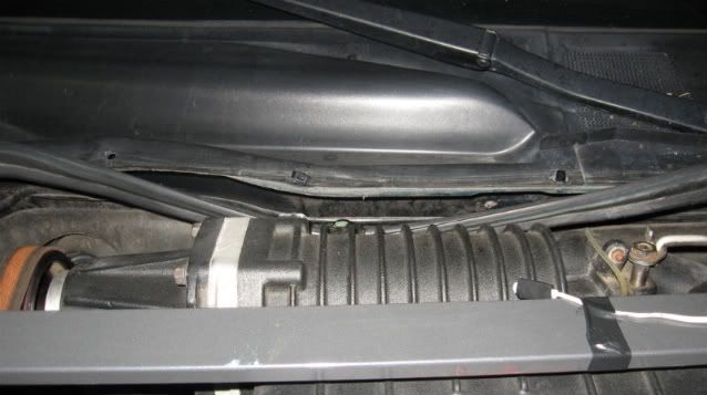

first thing i did was buy a remote thermometer. next i ran the temp probe into the engine bay and mounted it over the supercharger using the strut bar. making sure to keep it far enough away from both so the data would be compromised by the heat soaked into the metals. i then picked 2 different local roads to do some testing. one was stop and go and the other was highway. in both tests i boosted several times to get the temp up.
for the first test i drove the hood as it is stock, not vented both on the stop and go and highway and made several passes making sure to note the outside temp. the second test i pulled down about a 1' strip of the rubber weather stripping that seals the hood and firewall when the hood closes. it was enough to allow about a 12"x1" gap between the cowl and hood, not a whole lot. the results are as fallows but i averaged it to keep from having to go through the numbers on here.

Postby bigbirdSCed » Mon Jun 30, 2008 12:19 pm
the theory i have is this. based on the behavior of air as i understand it. air moves from high pressure to low. on most cars, assuming the camry is no different, there is a pocket of low pressure air that sits at the base of the windsheild. so some of the air that is moving under the car (high) that would normally just pass by is moving up through the engine bay and along the firewall and out the gap at the back of the hood to meet up with the air pocket there (low). given im no scientist so i may be way off.
here are the pics Vik. this is not my perminent solution, just used it for testing.
