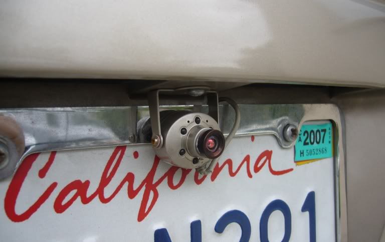

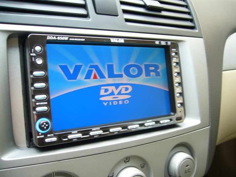

Hey folks, I've had my X|O Vision backup camera ever since I had my stereo done but I never got around to posting pics of it until now.
Oh yeah, notice how I closed off the gaps on the OE Navi. dash kit. I cut up some fiberglass pieces and used Epoxy to get it to stick. The paint is a perfect match.
If anyone is interested on the paint code/brand PM me and I'll dig it out of my garage. Enjoy!

looks good! was there any other place to mount the camera?

hskrsolara wrote:looks good! was there any other place to mount the camera?
If you have the Toyota OEM Navi unit, the Eclipse BEC 105 (wide angle) camera is a direct fit to the navi unit.
I mounted mine on the license lights/ lift gate door handle assembly.
The camera lens is on the left (hole) and the right is the key hole.
Photo was taken while I'm backing up on my drive way.

hskrsolara: I guess you can mount the backup camera on the bumper or something, but the current location its mounted makes it look flush with my solara.

i see...I have always wanted one, but was concerned with placement. good job, now you can get tailgaters license numbers with the click of a button!

While I think a back-up-cam is a sweet mod, whatever way it is done: SiennaSC98: I really like your install. If you didn;t tell us there was a cam in there I'd never have guessed.

that all looks really nice. i love the H/U

Postby siennasc98 » Sun Apr 23, 2006 8:00 pm
Sentinel wrote:While I think a back-up-cam is a sweet mod, whatever way it is done: SiennaSC98: I really like your install. If you didn;t tell us there was a cam in there I'd never have guessed.
Thanks.
I did consider these three areas where to mount the camera.
Bumper – Too much work is involved to run the cable inside the van and all the way to the console. The bumper is also reinforced with a thick metal and will be hard to drill a hole.
Spoiler – The (body) camera will be exposed to the environment.
Garnish – Perfect location since the BEC 105 camera is small enough to be tucked inside. Though the camera does not cover about a foot of the back area, the backup sensors that I have will pickup any obstruction.
