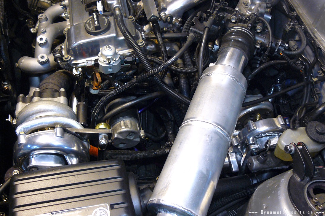

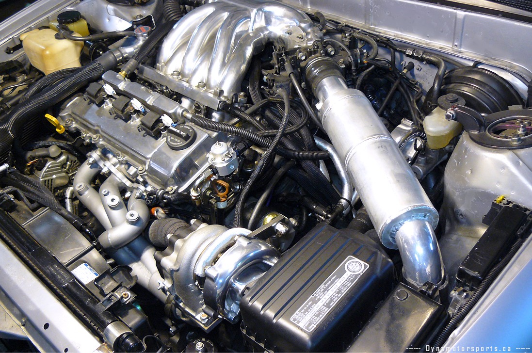

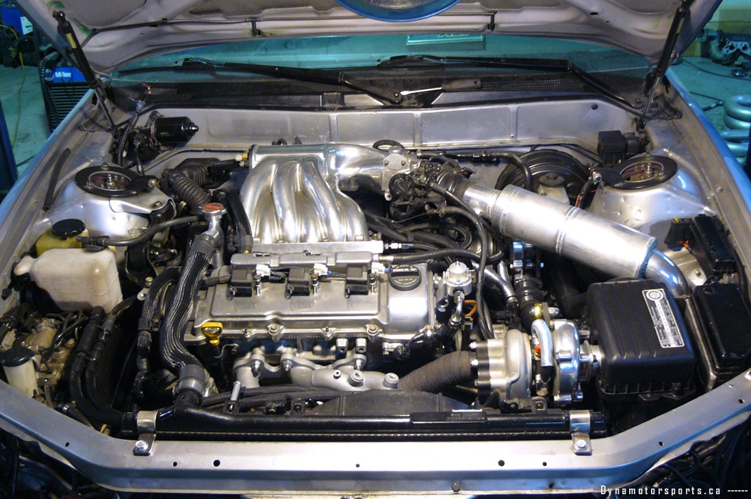

Engine bay shot #1:

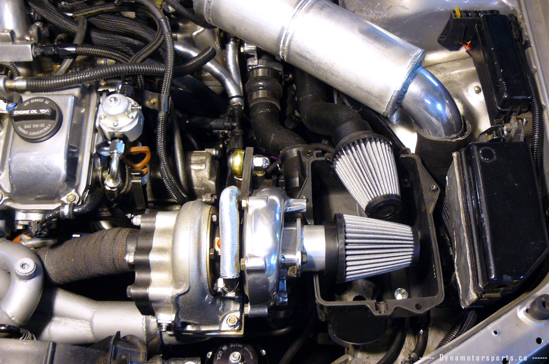

Shot of two turbos:

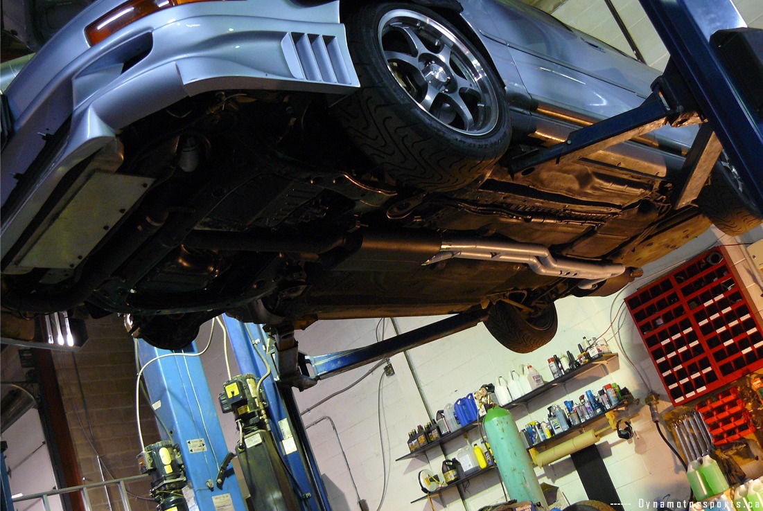

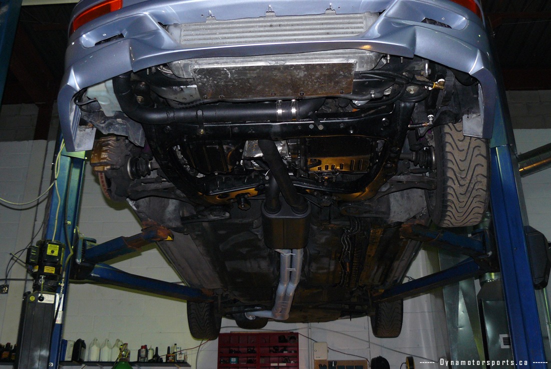

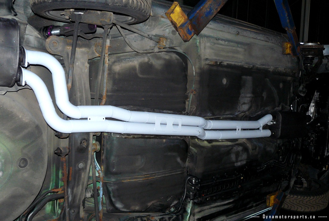

Underbody -- downpipes and dual 2.5" Exhaust. The muffler you see is not just a regular muffler, but it is the Dynomax perforated "X-pipe" which equalizes the pressure from my unequal lengthed downpipes:
Another underbody shot:
Exhaust -- Dual 2.5" is roughly the total flow capacity of a single 3.75" exhaust. I did the dual pipes for maximum ground clearance, noise cancellation and also to match the dual inlets of the Supra TT muffler I am using. The car is going to be stock-like quiet, but free flowing well up to 500 WHP.

I think either tomorrow or Monday, I should have a video of it starting up :D Shortly after that, the Camry is going straight to the dyno. You can't beat the convenience when the dyno is literally 5 secs away :clap:

btw- I like how u got the filters running into the stock airbox. looks stock :)

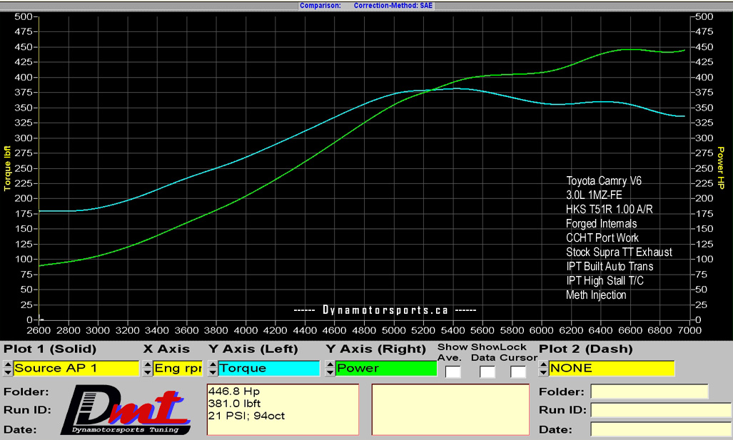

Numbers:
447 WHP & 381 lbft @ 20.5 PSI low boost setting
Goal for 2009 is 600+ WHP on pump gas
