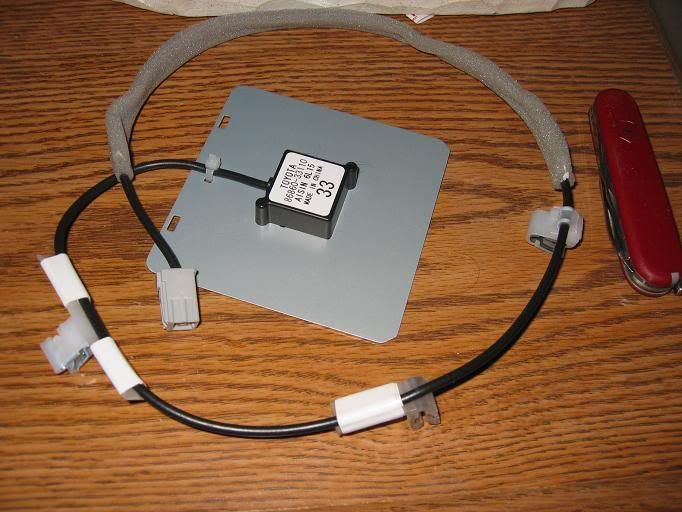

Postby Sparky5e » Tue Jul 03, 2007 10:34 pm
I have a limited amount of cable and it has clips I assume are for mounting in a particular place. I like how the other one is mounted, but can't do that. Here's a pic of the antenna and the box is rivoted to the plate.

Postby PXLpainter » Wed Jul 04, 2007 12:21 am
Oh! Holy CRAP! :o
Guess you can't put that in your dash then eh? ;)
Maybe rivet it to the roof or your hood?
:rofl: - I know - I'm no help whatsoever... sorry.
Postby MCOjerry » Wed Jul 04, 2007 8:46 am
might be meant to mount under the trunk lid.
Postby kingkakyle » Wed Jul 04, 2007 12:47 pm
MCOjerry wrote:might be meant to mount under the trunk lid.
that means he would need an extension cuz that cable is short
Postby MCOjerry » Wed Jul 04, 2007 1:00 pm
right, but in a stock equipped Solara, there might be a plug for it. Perhaps there is one in there hiding. Best bet would be to call a dealer and ask where it's supposed to be installed.
I only metioned the trunk because on the Audi A4 Cabriolet, the satellite antenna is located under the trunk lid.
So, perhaps there is a piece missing, or the plug is already wired there, just hidden.
Postby cklinh » Wed Jul 04, 2007 1:29 pm
The OEM navigation's antenna is definitely somewhere under the dash. I had to get that checked when I didn't have reception, and they opened the dash to access it. Of all the times I've pulled open the dash, I've never noticed where the antenna is though...
cklinh
Posts: 1879
Location: NorCal
Postby HID04V6 » Wed Jul 04, 2007 7:20 pm
The NAV antenna can be anywhere inside of the dash, but the closer to the top of the dash it is, the better it is going to work. I think (from all of the times my NAV has been pulled out) that the OEM NAV antenna is located up near the trip computers- up near the top of the dash, so it can tell which direction your car is moving.

Postby Sparky5e » Wed Jul 04, 2007 9:01 pm
Well it's in and sort of working. I crammed the damn thing on top of the vents wrapped in foam temporaily so I could slap it back togther. I have to take it out again anyway. One plug needs to be converted so the Mic will work and tie in the rearview camera. I looked for the correct plug but wasn't found anywhere so need to find a R10 connector and extract the wires from R18 for it. I think the guys at siennaclub have the part number and I have all the wiring diagrams so it's not too bad.
Actually I am getting into this, nothing like a challenge when you can see the rewards of your labor.
