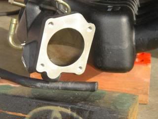

Sorry, I'm the one who bought it though some of the accessories are missing. Externally, it's on good condition. I will use it as a spare for my existing (~50K miles) S/C which is now showing some oil leak at the nose. I will do the swap and test it this weekend. If it's decent enough to use then I'll send my original for recondtioning.
Here is a close up picture of the S/C;

I contacted PSE Superchargers Inc. (www.psesuperchargers.com) and they told me their standard remanufacture for my our supercharger is $700 which is ok if all bearings are replaced.

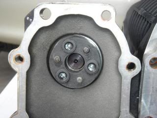

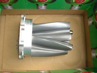

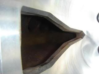

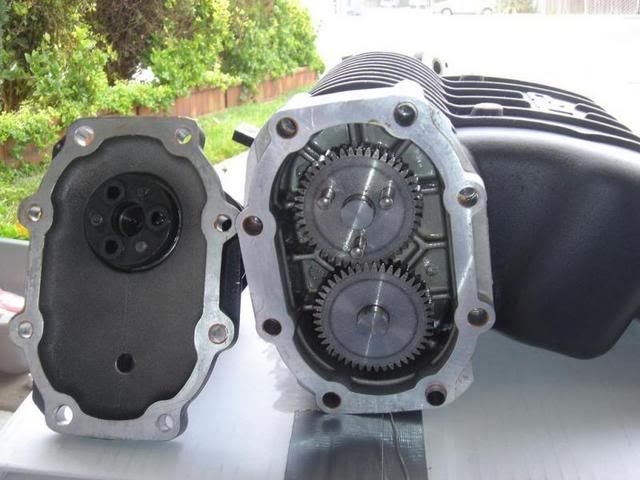

Want to make sure the S/C unit is really in bad shape and that it's due for a rebuild. I dismantle the unit and found out that the internals are still in good shape but need some serious cleaning. Here are some pictures;
The nose and drive gears;

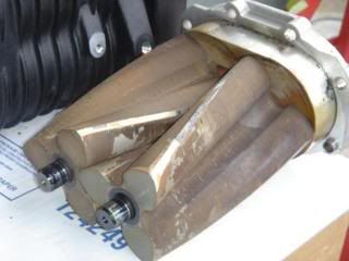

The impellers (before and after);
Image Image

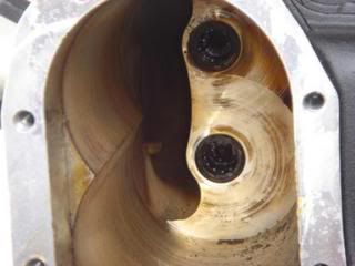

The inside of the housing;
Image Image

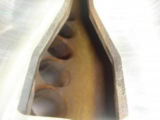

The intake ports;
Image Image
The coupler is still in excellent condition.

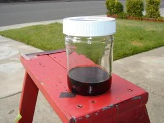

The original (drained) oil, it's already black and this is the only one that I need to replace.

Postby Akfahad » Sat Dec 09, 2006 9:48 pm
thanks for the pics, never seen the insides before....

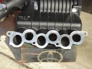

Postby CASTRO » Sun Dec 10, 2006 2:13 am
mwahahah, i love the toyota symbol on the chunk of wood under the s/c.
thanks sienna for the pics, now i feel a lot better about taking mine apart for a good cleaning and reoiling

Postby siennasc98 » Sun Dec 10, 2006 1:33 pm
Ruskimafia wrote:looks good man Great find on ebay !!!!!

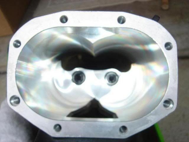

Yes indeed. I still have to clean the air chamber. I need to find a flexible wire brush to reach the intake ports and sorroundings from such a small opening.
Image Image
Cleaning the impellers is a pain. Thanks to my general (the wife) for mentioning that acetone is perfect for caked/hardened oil film (from the oil vapor coming from the PCV and front valve cover breather > intake tube).
Image Image

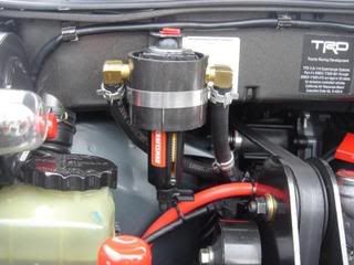

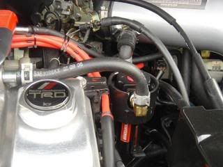

I'm hoping that my DIY oil catch can/bottle (from Craftsman - compressor line filter) that I installed will minimize the accumulation of oil film on the impellers.
Image Image
