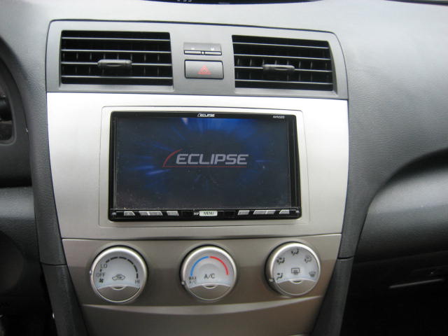

By this pic, looks pretty good for fitment. If you're gonna get everything painted, then color doesn't matter

I'm not sure how your hvac control panel is, but there's a huge gap in the camry
http://www.toyotanation.com/forum/showt ... p?t=190441
http://www.toyotanation.com/forum/showt ... p?t=341759
http://www.suburbanradio.com/10Camry.JPG
http://www.toyotanation.com/forum/showt ... p?t=155133

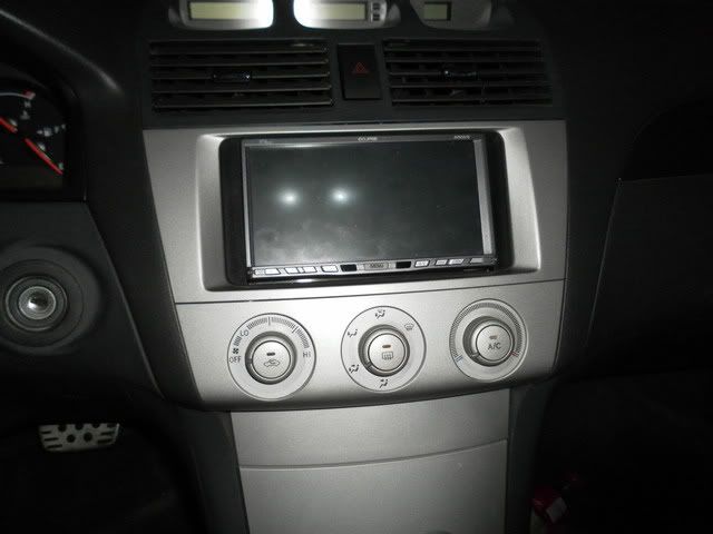

Thanks for the links. I would LOVE to get my hands on the Power Acoustik one!!! I don't even know if they make one for the Solara. I know the Camry and Solara peices look quite similar but are in fact different. I read it in an old post here. Below is the same interior I have in my 2004 Solara SE Sport, except I don't have Climate Control. I have 3 dial knobs.

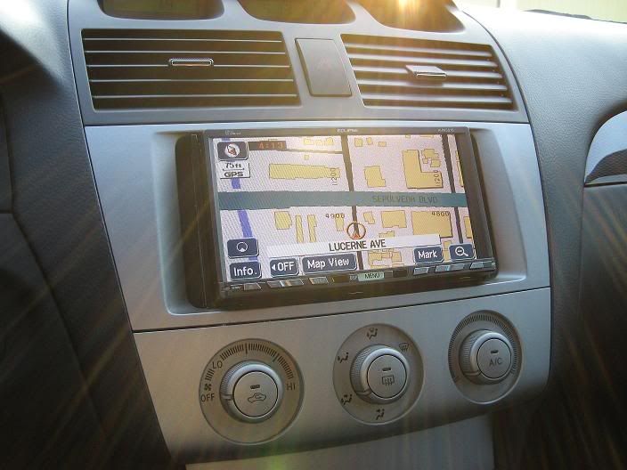

Postby kingkakyle » Wed Mar 16, 2011 6:13 pm
let me find my pic thread
but yes its the one toyota uses for their nav
i have an eclipse avn 5500? and it fits except on the sides theres gaps,
so i bought these side fittings things, it'll be more obvious in the pics

Postby kingkakyle » Thu Mar 17, 2011 1:58 am
ok i realized i didn't take pictures of when i redid it cuz it was sticking out lol
ill take some tomorrow
i used the existing brackets from the stock, but had to drill a bit
ill show u why in the pics tomorrow
Re: Double Din Installtion Kit. Best fit, color, etc.
Postby kingkakyle » Thu Mar 17, 2011 7:42 pm
thats what it looks like now
there are these black spacers on the side i had to add because my unit is not wide enough
thats sort of shows the color
this is what is looked like at first, without the spacers
i also had to drill new holes for the brackets because otherwise it stuck out like a mofo
but that could be specific to my unit
but it no longer sits like this
