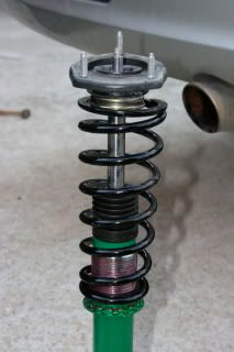

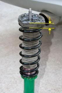

I'm in the middle of my Tein coilover install, but have a question (opinions needed) for the rear. We re-use the existing OEM upper mount. But for the rear, this is an assembly that includes the insulator (i.e., rubber cover). There is even a tacky adhesive that holds the rubber insulator to the upper mount. The insulator will fit inside the Tein spring, but my question has to do with the thickness. At the top of the insulator, it's about a half inch thick - so it essentially adds a half inch of compression to the springs. Furthermore, the Tein install manual shows a diagram of the stack up of parts, and they show the upper mount WITHOUT the insulator present. That diagram leads me to believe that they don't intend on you using it.
So do the Tein settings account for the half inch spacing or not? I guess I could finish the install, and then measure to see if it works, but I'd like some opinions. Below is the A vs B look. (Note: The left picture shows the upper mount. The right picture JUST shows the insulator, with the upper mount missing.)

My installer had the same problem installing mine... I think he left it on, while trimming some of the lower part (that goes inside the spring).
I'd assume it was supposed to be left off, but I haven't noticed anything major.

Thanks for the reply. I did the first rear wheel WITHOUT the rubber insulator. But there was a LOT of slop between the strut top and bottom, and you had to raise the spring seat up quite a bit to get the spring to begin to compress (with the rear end jacked up, mind you). And after a while of thinking about it, I thought that I preferred the spring compressing against the rubber - instead of metal on metal. SO, I took that coilover back out and re-did it with the insulator back in.
Curiously, even with the half inch insulator between the spring and top mount, my back end still sat almost an inch lower than what was specified in the Tein manual. Perhaps the convertible sits a little lower in the back end because the weight distribution is different? Anyway, took the rear wheels off and I raised the spring seat up a bit to compensate.
It's all good - and I'm happy with the setup and drop. My wheels are about worn out, so I'll let them lose a little more tread and then have an alignment done when I put on the new tires.

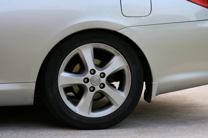

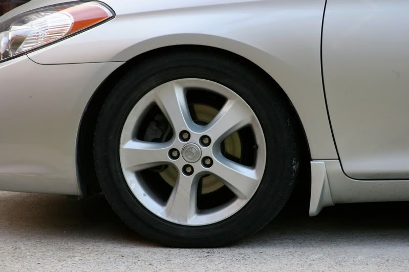

Here's the current drop. I dropped it 2.1 inches in the front (per Tein), and ended up only dropping the rear 1.5 inches, (a half inch less than outlined in the Tein manual). I could still drop both ends more, but wanted to try it there first. What do you guys think?
