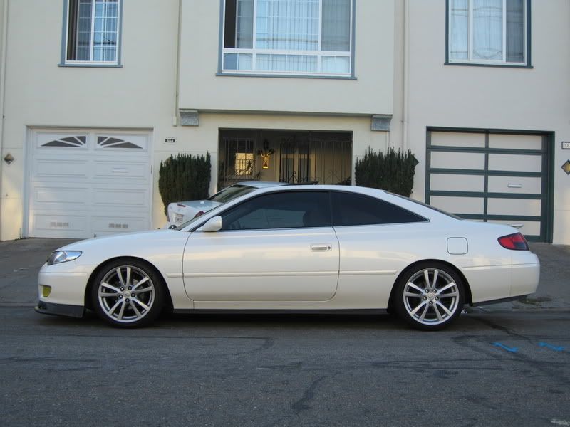

I am thinking about the IS 350 wheels, but the rears are offset because it's RWD....Can I still fit them. I have no plans to lower. I really like the 08 graphites, cool look at toyota quality. Let me if any one has done this.

whats the size of the wheels? whats the offset?

18x8 in front with an +45 offset
18x8.5 in rear with an +50 offset
I really think they will fit...I guess my question is has anyone done this and did they experience any issues ?

I THINK you're gonna rub like a mother in the rear :-?

Sparky5e wrote:Jeff has Lexus wheels. Not sure if he red this YET but sure he could help.
pxlpainter? he has g35 wheels..
Postby Somedude » Thu Oct 16, 2008 7:37 am
Yea the G35 wheels did rub when Pxlpainter first put them on, I remembered he had to do something to make it fit.

Postby akora12 » Thu Oct 16, 2008 8:09 am
Toy1mzfe's ride:
To my knowledge, he had to trim/pull the rear fender to make them fit, but he should chime in on this.
I also have the same rims, but I bought all fronts to avoid fitment issues.
Postby sahuddleston » Thu Oct 16, 2008 8:34 am
i would think you want the oem 18's, not the oem 17's that come on the AWD IS. i have a set of the regular 18's with tires for sale if you are interested.
you should be able to run the staggered set up with a spacer.

Postby ---CAMRAZY--- » Thu Oct 16, 2008 3:22 pm
I would do the 18x8.5 all around with a 15-20 mm spacer and some 225/40/18 or 235/40/18 depending on the drop.... Cut the rear inner fender lip... and some slight negative camber with some toe in.... lol
Postby Toy1mzfe » Thu Oct 16, 2008 5:08 pm
Rock them spacers in the rear!!!!! u need them. Friggin +50 is no joke.haha
18x8 +45
18x8.5 +50
i think U can get away with the fronts.
but the not the rears.
I am also riding with the staggered offset but all four with same tire size.
Postby PXLpainter » Thu Oct 16, 2008 5:11 pm
---CAMRAZY--- wrote:I would do the 18x8.5 all around with a 15-20 mm spacer and some 225/40/18 or 235/40/18 depending on the drop.... Cut the rear inner fender lip... and some slight negative camber with some toe in.... lol
^^ Exactly what Milt says!!! HE should know about this sh!t more than anyone here!! ;)
And yes, I have G35 rims 18x8 30 offset, and I trimmed my rear fenders and got a camber kit for the rears.
Postby Toy1mzfe » Thu Oct 16, 2008 5:15 pm
^^^^ if its like that.
do 18x8.5s all around and use 20mm spacers so it becomes +30
and trim ur rears.
Postby Aotoyota » Thu Oct 16, 2008 5:29 pm
be careful with the offset! im running a 35 and it rubs all the time. but im also running trd springs.. gonna get it rolled soon! good luck
