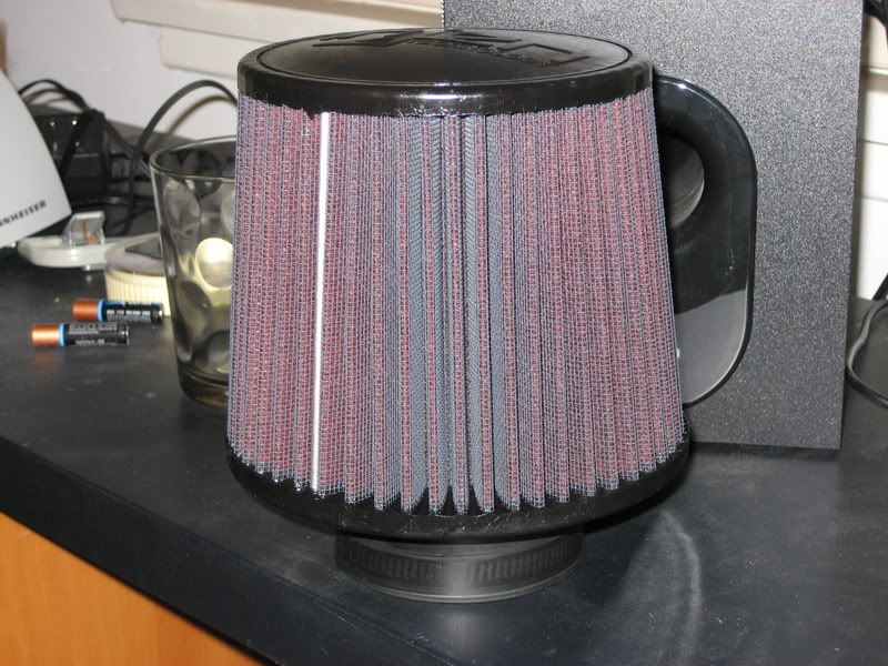

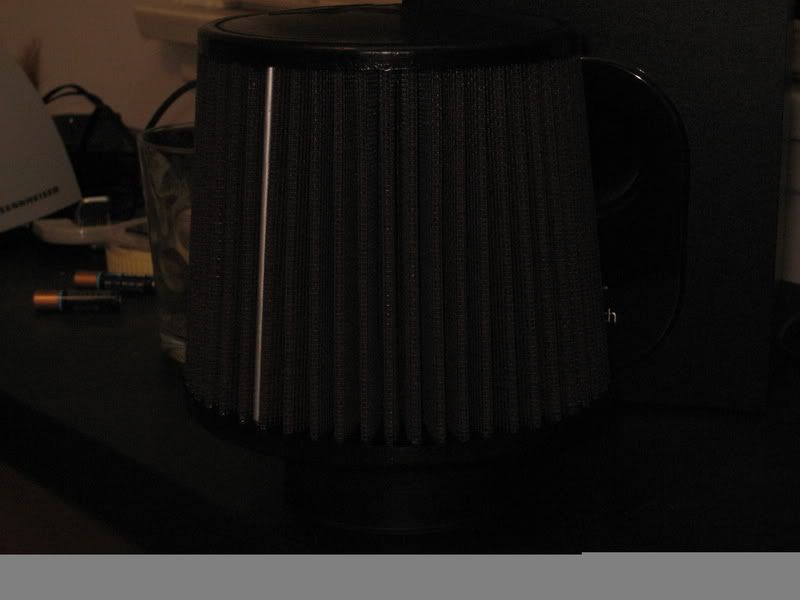

i did take a pic cuz i was gonna post it....but the lighting makes it look nothing like it really does....ill try again though

some pics
Postby crispone » Mon Mar 05, 2007 10:18 pm
^^^ From what I can tell between the two photos... you can bolt it on and RUN IT!
(That doesn't look saturated enough to restrict your airflow too much. I STILL think it will flow better than stock paper element filters from the appearance, and the "moderate" appearing "over-oiling" is not going to cause an issue. It will begin to "pale-out" again with some miles...)
crisp says:
"LET 'ER ROLL!":D
Postby ClassySolaraGuy » Mon Mar 05, 2007 10:30 pm
It looks fine. :D Install it & forget about for another 20000 miles or more. 8)
