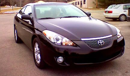

Well, the tires finally showed up; Jamie wanted the fattest tire I thought could possibly fit on her rims, and talked me into 245/50-16s (which are rated for 7-8.5" rimwidths) in Kuhmo Ecsta ASX's. I was MOSTLY sure they would fit, but still a bit sceptical... today they showed up, and they fit perfect! Lots of room on the front, even when turned all the way; the backs do sit a little close to the strut body (about 1/4" away), but they haven't rubbed yet, and most likely won't unless we put a few big dudes in the back seat... even so, spacers may be coming in the near future.
I can't wait to see how she handles on a dry day!

So far, so good... went all around the county with four adults last night; railroad tracks, bumps, sharp corners... not one single rub! One thing I do need to take care of, however, is the alignment; the stock Michelins on the REAR showed signs of wearing out in the shoulders after only 12k. I'll be making a bit of camber adjustment for sure!

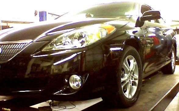

I ordered wheel spacers even though I haven't noticed any rubbing; they should be in tomorrow. I think they will help with the appearance of the car, add a little more security, and help handling a tad. After measuring, I found that the rear wheels sit in 3/4" farther from the fender lip than the front, so I ordered 1.25" spacers for the rear (the kind that bolt up and have their own studs). I had a set of 1/2" spacers in my toolbox that I will use for the front; these get simply set in place, so I will install longer wheel studs. If all goes as planned, I will have them on and re-align the car tomorrow night... I'll post the results then!

Update: I finally installed the wheel spacers last week, and here's a picture of the results. The half inch spacers went in perfectly up front, along with 50mm studs from Ichiba. In the rear, I used 1 inch spacers, as 1.25" was a little much for my tastes (too musclecarish). As you can see, the results are much better than stock; a cheap way to fill your wheelwells at any rate!
This is a great site for studs, spacers, etc: http://store.ichibausa.com/toyota.html
I hooked it up to the alignment rack (no easy feat with rimsaver tires!), planning to add a little extra neg camber, but was surprised to find I had to make no adustments. The front and rear were already set in the position most performance drivers beg for; two thumbs up for Toyota!
