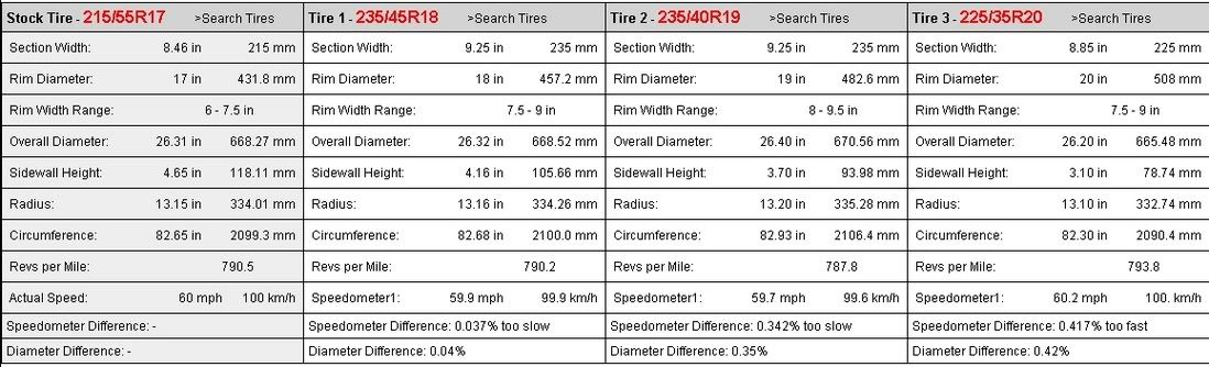

Appearance is important as well. Since my car is lowered, I wanted to avoid that terrible "Toyota Gap" between the tire and wheel well. Since the OE tire fit in there so well, I needed to stay with a tire around 26.5" in diameter. For an 18" wheel, this pushed me to use 235/45/18 tires. (See below)
These tire sizes are the idea diameter to keep your speedo readings accurate and not increase the gap between tire and fender. Before you commit to the wheel change, check the tire prices. The 235/45/18 tires that I have were a rare size. I found these on EBay for less than $400 for a set. They are GoodYear private brand called Essenza. (A summer tire only) Otherwise, I was looking at $250 / tire for Pirellis. :(
Beware of the "tire and wheel" packages you get online. Mose sport compacts run a smaller tire so the packages are usually like 225/40/18. This is passable but I didn't like the increased gap. (Tire is around 1" smaller in diameter so the gap is + 1/2")
