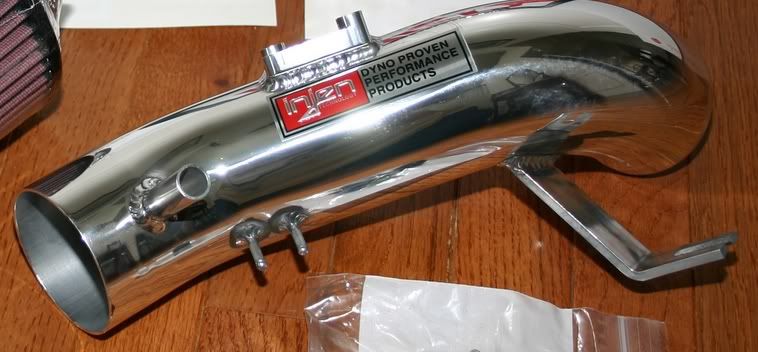

Postby TRDMIKE3 » Tue Aug 02, 2005 3:54 pm
I just got my 3.3L intake and the two 4mm vacuum lines above the fuel rails are suppose to hook up with the 2 3/16" vacuum ports on the intake.
Are the two ports suppose to be hollowed out?, cause
mines is not. Is that a defect?
thank you
mike

Postby PhreakdOut » Tue Aug 02, 2005 8:26 pm
I noticed the same thing. I couldn't tell if the hole is really small or what.
I went ahead and intalled it anyway looking for CELs. I'd forgotten about it till you mentioned it.
This is a good question for Paul Ho at Injen

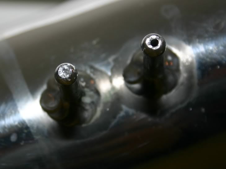

Postby PhreakdOut » Wed Aug 03, 2005 12:29 am
TRDMIKE3 wrote:I called injen and they wanted a pic of the intake. but i don't have a digital pic to send. they don't know what's going on. I'm scared to drive my car now. my ports are completly sealed, i don't know weather to open them up or leave them as is.
well how's your car been runnin with the same situation?
If you don't get to it by this weekend, I'll pull it off and take some hi-res shots. I suspect it occurs during the polishing process. This probably isn't an issue on the powder coated parts.

Look for two vacuum lines going from under the decorative engine cover to the upper left side of the OE intake box. Injen has us route them into the side of the new pipe. See the two nubs at the bottom.

Postby PhreakdOut » Sun Aug 07, 2005 3:36 pm
Thanks for the info Doc! I took mine out this afternoon and sure enough, the holes were filled. (I wonder if I missed something in the instruction sheets.) Am I supposed to read those?
I'd drilled one and started on the second when I remembered that I needed to take a pic of it. So here it is, partially boared out.
