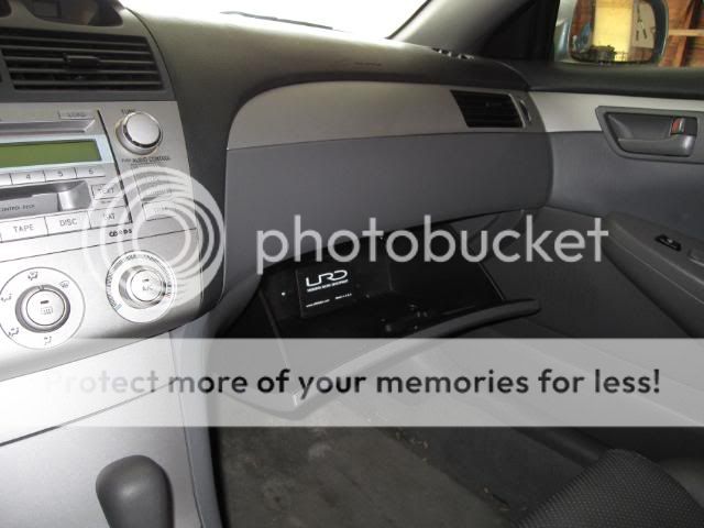

Today I mounted the URD MAF sensor calibrator in the gloved box and soldered it in. When I hooked the battery back up The car revved to 1500 and died. The map on the urd was for a stock intake and exhaust so I expected trouble but not total failure. Thinking of a solution to make the car driveable I figured the injen intake was as close to stock that I had so I replaced the CP-e with it. After the switch no problems. When I go to get the box tuned I'll throw the CP-e back on.
Jeff- did you ever get dynoed with the whole set up?
Here's some pics of the URD install today:
I also installed the O2 sim and after an hour of driving no CEL :D
