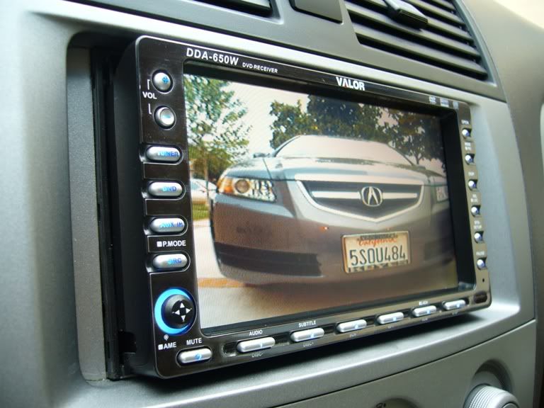

times like this i'm glad i have my backup camera!

I'm planning to buy purchase a back up camera and screen. The rear visibility on the convertible nearly borders on hazardous.

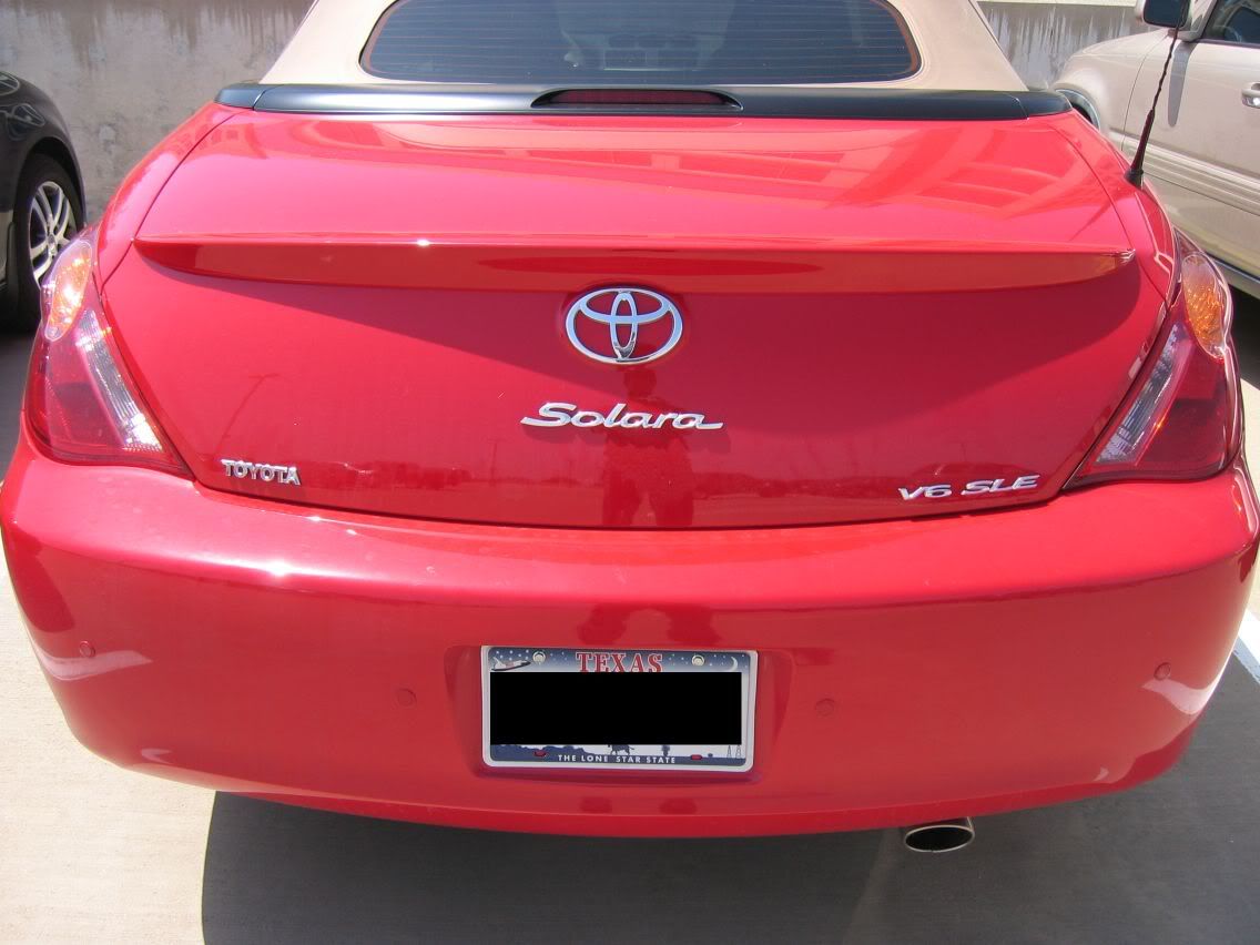

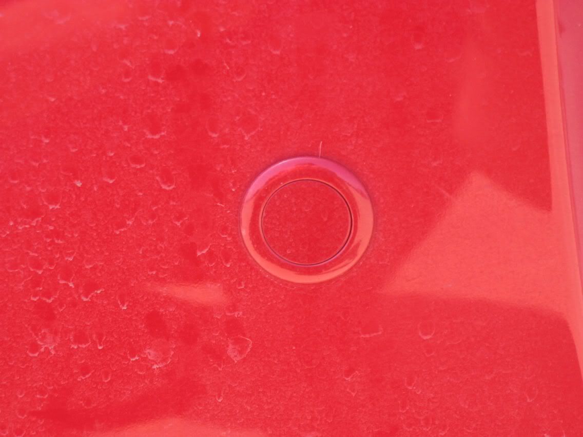

Here are some pics of an in-bumper ultrasonic sensor setup that I took from an unknown Solara owner at my workplace. I've left a note for him to give me details on his setup, but I don't know the guy. We'll see.
Anyway, here are some pics. I don't think it looks too bad. Although I'd certainly prefer the 'invisible' look.

Postby whdean » Tue Jul 11, 2006 11:44 am
I looked at those before I decided on the doppler sensor.
I think that the ultrasonic sensors will work fine most of the time - They are certainly cheaper.
The advantages are:
1) Cheaper
2) Longer sensing range 14' vs 9ft.
The limitations appear to be:
1) Obviously an invasive procedure - Holes drilled in bumper skin. You could pull a doppler unit when you got another car and leave no trace of it.
2) Dirt, snow, grime will limit their effectiveness.
3) Winds over 12 mph will interfere with the ultrasonic signal - It's just very high pitched sound and the wind will interfere.
4) One or more of the ultrsonic sensors can go out and the unit will still work - But it does not let you know of the problem - A corner could be unprotected and the unit appear to be working. The doppler unit give a green light OK signal each time the car is put in reverse - You know if it's working.
5) Not very effective sensing obstructions to the side of the rear bumper - The sensors are aimed primarily towards the rear. With the doppler unit, you can walk up to the rear of the car at a 45 degree angle and it will trigger it if it senses that the car is angling towards an obstruction- ie - backing and turning slightly and hitting a post - What happened to me.
4) More false alarms - Ultrasonic units detect only static objects, including the ground, if the car is on an incline.
5) Ultrasonic units do not detect all the way to the ground - this is more a saftey feature - ie - A fallen child behind the car - than it is a warinng that the car is abuot to be damaged.
