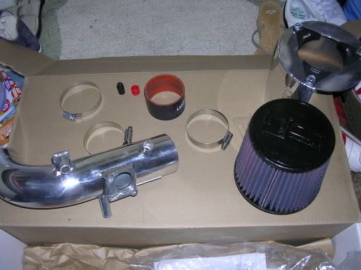

Postby kingkakyle » Thu Jun 08, 2006 6:12 pm
i have a feeling im missing something?
i have a 4 cylinder
heres a pic of wat i hav....
and wat goes in those 2 spaces where i put the arrows???
thanks
Postby PXLpainter » Thu Jun 08, 2006 7:13 pm
What do the instructions say?
Mine came with step-by-step instructions... but it also didn't look like that!
You must have more hoses on the 4 Cyl. ;)
Postby kingkakyle » Thu Jun 08, 2006 7:19 pm
instructions say but its confusing cuz the black nipple thing doesn't fit where i think it goes and then red one still leaves the opening on the hole thing near where the filter goes...
i guess i gotta get a ruler out
help from someone who has a 4 cyl would be greatly appreciated ^ ^

Postby Down2TheC » Fri Jun 09, 2006 11:48 am
Tact... lend a hand! He'll know. V6 has a different hose setup so I don't know if that's even the right pipe. I don't recall anyone mentioning a heatshield either. Hard to believe the I4 needed one when V6 didn't. Is there any model info on the pipe? That may be for another car... but again... I don't know the I4 model.

Postby DaOnoKine » Fri Jun 09, 2006 12:43 pm
Use hand soap or another type of lube to insert the black nipple where first arrow is. This is for the vacum line bracket, which I had probs fitting properly. I couldn't fit this bracket on 'cause the lines prevented the bracket from reaching this position, even if i adjusted the postion if the intake pipe. I just used zipties to secure it. As long as this part is not floating around the engine bay, there should not be any probs.
The red nipple is installed at the second arrow. The instructions describe a carbon canister to be inserted here, but us Solara 4cyl peeps dont have this part located here. I used a stainless steel cap to cover this hole. You may want to use this or a rubber stopper to perform this task. To sum it all up, both rubber pieces did not serve any purpose for me. It may be different for others though. Hope this helps.
