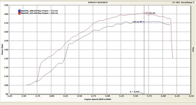

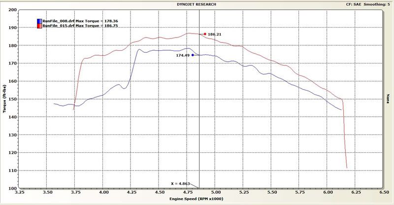

If you search a bit, you'll see that a couple folks have dyno tests that prove it... mine will be coming in shortly and I'll be comparing the Injen to the CP-e back-to-back.

For results, the tuning of the customizer does make a difference. For independant evidance, wait for PXLs reaction or read the reaction of Crisp the day he installed it. It's like it's not the same car.
With travel and speeding tickets and such, I spent >$500 on my proto and I've never regretted it.

Postby crispone » Sat Mar 17, 2007 7:53 am
There is your answer to "does it really make a difference".
Hard numbers, at the wheels. Trust me, you CAN feel a dozen HP or TQ number differenc on these cars...
Good luck with your choice...

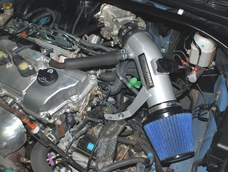

Postby crispone » Sat Mar 17, 2007 8:00 am
There are some of the "parts" to the kit... and the end result. The filter WAS preoiled in my case... however, with a "K&N" degreaser/oiler kit... I suspect you could REUSE the CP-e kit filter, which is an "afe" brand element, and oil it RED if you wanted. For ME, the BLUE works out nicely on the cosmic blue of my car! :wink:
Postby crispone » Sat Mar 17, 2007 8:03 am
^^^ BTW, I HIGHLY recommend buying the degreaser/filter oil KIT when you get the CP-e... as the filter DOES need reoiled periodically to keep the element moist. I JUST reoiled mine for the 2nd or 3rd time since installation... about once every 3,000 miles or so. (Driving patterns WILL affect the frequency of oiling... I "hammer" it pretty regularly... 8) )
As for the cost? I paid $601 total INLCUDING the oiling kit and the TUNEABLE option MAF, and I have ABSOLUTELY ZERO regrets, and absolutely zero reservations over recommending it to ANYONE.
