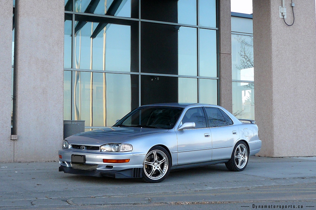

Don't know how many of you frequent TN or check on the work of Camry vet Tony the Tiger, but I'll post anyhow:
Link to TN videos regarding Tony's twincharging
Tony the Tiger wrote:Here's a brief list of the setup:
'94 Camry V6 LE
1MZ-FE 3.0L V6
Wiseco 8.0:1 CR Pistons
Pauter Forged Connecting Rods
3MZ-FE crank, balanced and radiused
CCHT Ported Cylinder Heads
Engine Built By CCHT
Fully Balanced with Flex plate, crank pulley, etc..
CatCams Valve Springs
SI 1mm Oversized Valves
TOGA Oil Pump
ARP Main Studs
ARP Head Studs
2001-up OEM Toyota 1MZ MLS Headgasket
FAL Oil Sandwich Adapter (Oil feeds)
Custom Sidewinder V-band Turbo manifolds
4" Downpipe
3.5" Midpipe
3" Full Aluminum Exhaust
XForce VAREX Electronic Muffler
HKS T51R KAI BB Turbo (71mm); 1.00 A/R
TRD Supercharger, gives 6 PSI (5.5PSI pulley though)
68mm Overbored Throttlebody
Precision 750HP FMIC; 31.5" x 10.5" x 3.5"
Synapse Synchronic BOV
Tial 44mm Wastegate
Shore 80A Filled Front Engine and Transmission Mount
Solid Transmission Torque Rod Mount
Custom Urethane Dogbone Mount
Import Performance Trans (IPT) Built Automatic Transmission
3000RPM Stall Converter
Custom Manual-Matic Shift Control (Manual gear control)
Dual B&M Hi-Tek Transmission Coolers
Delphi 720cc/min Injectors
Custom CNC -6AN Fuel Rails; dual feed
Dual Trickflow inline Fuel Filters
Dual Walbro 255 LPH Fuel Pumps
Painless Fuel Pump Relay Kit
Turbosmart Fuel Pressure Regulator
'03 Toyota Highlander Alternator
DMT Meth Injection (M5 Jet)
Turbosmart E-Boost2 EBC
APEXi Turbo Timer
PLX DM200 Organic Display Gauges
Dual Wideband O2's
PLX Oil Pressure
PLX Transmission Temp
PLX Water Temp
AEM 1060 EMS Standalone
AEM IAT and Coolant Temp Sensors
AEM 5-Bar MAP
Motec Hall Effect Crank Sensor with Trigger Wheel
Milled OEM Toyota Cam Sensor
Haltech Ignition Modules
Factory ECU/ Standalone layout; controls transmission and stock functions
HKS Twinpower DLI
MSD Voltage Ignition Booster
Chrysler 300M Coilpacks
Denso IK34 Plugs, gapped 0.022"
Battery Relocated to Trunk
Hella Battery Kill Switch
KSport RoadRace RR Coilovers; 15 kg Front & 13 Kg Rear
Whiteline RSB
2-piece Supra Front Rotors
LS400 Dual Piston Front Calipers
Porterfield R4S Pads
235-45-17 Pirelli 240 Sottozero
Volk SE37k 17 x 7.5" +40mm Wheels
+ a few I may have missed...
