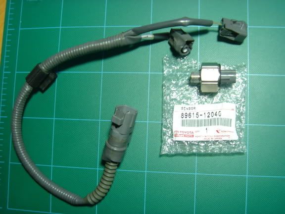

In my case, I cut the factory harness back too far when making the splice. There's a plastic encasing with a shielded ground wire that your splice connection can't touch. I tried re-shielding the ground on each wire, but that still didn't work. I ended up having to buy another OEM harness, part #82219-07010. It was around $30 retail.
This is siennasc98's photo, but it shows the same harness:

I tried installing the GM sensors with the screwed up harness, which obviously didn't work. After ripping my engine apart 3 more times to find out my harness was junk, I relocated the OEM sensor with the new harness and sold the GM kit. Now, if my sensor goes I won't have to tear apart my engine again.
I have no way of knowing if your GM sensors are bad, but I know they can be tested. I would ask your mechanic if his splices were before the plastic encasing.
