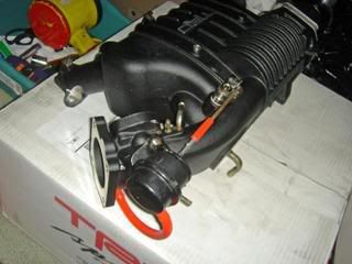

Theres a little "flapper thing" or bypass on top of the blower that has an arm/lever attached to it. Follow the hose and just hook it up directly to a vacuum port underneath the throttle body. That way boost overlaps everything the engine does and is more mechanical. I dunno how your hoses are setup, but by doing this method, it skips a lot of other hoses and is cleaner IMO. ill try and dig up an old pic to post.

Postby siennasc98 » Tue Dec 12, 2006 9:15 pm
CASTRO wrote:http://www.solaraguy.org/viewtopic.php?t=21850&highlight=ebc+bpass
can't find a pic that Vampire showed me but heres a big thread about a bunch of people talking about it and it shoudl give you a good idea of where to find it.
Is this the way you did it? The red hose from the barb on the by-pass actuator valve to the barb near the S/C - throttle connection plate.
siennasc98
Posts: 195
Location: 707 - Vallejo, CA
Postby CASTRO » Tue Dec 12, 2006 9:19 pm
kinda... but from the bottom barb, the hose goes on to the boost actuator bypass nipple. From the pic you posted, it doesn seem like anything is connected to the boost actuator bypass thing.
CASTRO
Posts: 2032
Postby siennasc98 » Tue Dec 12, 2006 9:27 pm
CASTRO wrote:kinda... but from the bottom barb, the hose goes on to the boost actuator bypass nipple. From the pic you posted, it doesn seem like anything is connected to the boost actuator bypass thing.
There is. Here is a better angle.
siennasc98
Posts: 195
