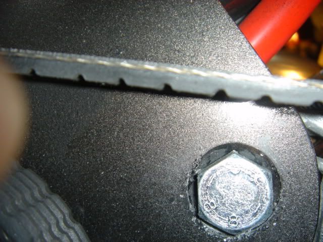

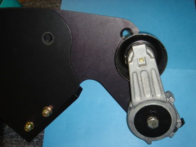

If the original (hex) bolt is long enough, it should work with the stock ( 3.2") pulley. The chance of the tensioner hitting the head of the hex bolt is in the event of a broken/severed belt.
6.0 psi pulley size is 2.8"
5.5 psi pulley size is 2.9"
Here is the picture of the belt and hex head bolt showing the clearance between them. I have the 5.5 psi pulley and stock size belt.
Here is the picture of the tensioner (no load) and the hole for the pivot bolt.
