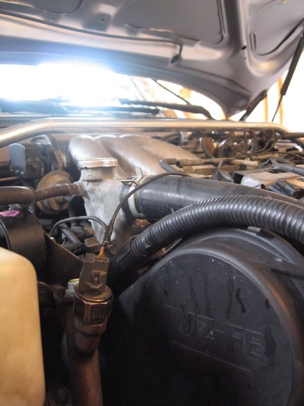

Well..here's my take. If you're running over 5.5lbs, then you probably want the sensor functioning. Thing is...will it really *save your motor*? Who knows. I've been running my 5.5lbs for over 8 yrs now...the last THREE with my CEL on! The motor is fine..very little oil consumption and I just dynoed at 258 WHP :D . I don't NEED the F##KN sensor around..period. If you can relocate it and think it's still *working * as intended, fine and dandy! Now...for those running 6lbs plus....DICY baby. I won't budge my boost...ever. I'm so happy that I NO LONGER have to deal with this issue. It's a real PAIN, since I believe the sensors really blow due to the noise/vibration from the SC itself (at least most of the time).

Postby Eye8Pussies » Thu Sep 24, 2009 8:42 pm
yes, it really will save your motor, quite definitely.
What does you running your car with the past 3 years with your CEL on have to do with the function of the knock sensor. It's possible that the knock sensor can pop from the s/c noise bouncing off the walls of the two banks (which is the theory when there are no fuel issues), or, for the gen4 camry/solara, it's from lack of fuel on the rear bank due to its returnless design, or, it could actually be knock.
the fact that your knock sensors were blown meant that your car was running rich for the last 3 years and retarding timing in safe mode, which would not hurt your car- at least not much - it may not be good for the valve seals, piston rings and emissions related components
anybody who says that knock sensor is useless really needs to go reevaluate their knowledge of how a motor works....that, or be prepared to drop a new motor into their car at any given moment.
It's not too hard to have a vacuum hose pop off while at WOT, mess up the MAF readings and have something go pop, or blow a meth line, or get some bad gas, or have their fuel filter clog up for some reason, etc. etc.
there are so many reasons why to have a working knocksensor that even extremely modified cars running stand alone ecus have knock sensors
Postby RON » Thu Sep 24, 2009 9:03 pm
I don't think it's *useless*.. in MY particular application, I would have to say *YES*. I just can't see any scenario that would cause my engine to blow or knock to the point of damage. Having said that...It's probably functional where I have relocated it..ON THE BLOCK.
I found your thread on TN and you have it here:
I guess it was functional there as well...as your account indicated.
So, according to your opinion, we're still *protected*. But for those pushing the limits, it's only a band aid as far as I'm concerned. Your're gonna destroy the internals running higher boost/pushing 300WHP...knock sensor won't save you there. :roll: . I'm sure you've read all the accounts of those who have ventured *there*...knock sensors not withstanding.

Postby Dawgz » Thu Sep 24, 2009 10:23 pm
RON wrote:I don't think it's *useless*.. in MY particular application, I would have to say *YES*. I just can't see any scenario that would cause my engine to blow or knock to the point of damage. Having said that...It's probably functional where I have relocated it..ON THE BLOCK.
I know u just didnt talk about running the car safe....
1) u had a CEL on for 3 years
2) ur on a stock fuel system, and after looking at ur Dyno graph, ur AFR's are lean as hell.

Postby RON » Thu Sep 24, 2009 10:41 pm
No arguments required. I rest my case.
BTW..the A/F readings from Church Automotive clearly state *our A/F readings are .7 -1.0 HIGHER than conventional pre-cat readings*. I was at 13.0...actually UNDER for most of 4500-6000RPM. I'll let you do the math. :wink:

basically, in my view, knock sensors are to make sure you can get home. it won't tell you if you are slowly damaging your engine from whatever, but it will prevent your engine from exploding and having you get a tow home a 1000km away from home.

Postby RON » Fri Sep 25, 2009 12:35 pm
