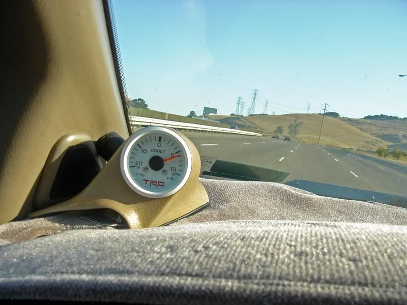

I have the 2.9" pulley and boost should be 5.5psi but I'm hitting the 6-6.5 psi mark on the TRD boost gauge. The fuel system (fuel pump/rails, injectors), thermostat, knock sensors are still stock.
Upgrades done for the 5.5 boost are:
- The spark plugs are Toyota (Denso) Iridium SK20RII, P/N 90919-01210(0.7mm tip, rated at 120K miles)
- New set of spark plug wires
- I have the Toyota air-cooled ATF cooler installed in the left fender
- I installed the CP-e MAFci (tunable) for the Solara Gen-1 and just using the base (default) fuel map that came with unit.
- Though not needed, the MAF and EVAP vsv-sensor were replaced during CP-e intake installation
- 130 AMP alternator from a 2001 Toyota Highlander
I have no issues and loving the extra (element of surprise) power.
My son took the picture and you might have noticed that no vehicles in front of me. We are climbing a hill and they are all behind. :D :D :D

DUDE you dont know how much I want your gauges :(
Been looking for one but cant find one for cheap at 10psi max
Postby CASTRO » Wed Nov 22, 2006 7:36 pm
i've got the same one... except mine is in black :)

CASTRO wrote:^
Can I have it :(

DatSRBoi wrote:
siennasc98 wrote:
Fletch wrote:My 5.5psi pulley had 2.9" scribed on it.
Thanks, you are correct. It's a 2.9" pulley and I edited the above post.
I bought mine from https://www.1sttoyotaparts.com/partscat.html
Item Number MSRP Core Price Price
ptr013502005 $99.00 $ 0.00 $71.28
BOOST GAGE ASSY VYTA - Tacoma 02-03

Postby krook » Tue Nov 28, 2006 12:36 pm
can you remove the gauge from the mount or is it all one piece?
krook
Posts: 2673
Location: Hawaii
Postby CASTRO » Tue Nov 28, 2006 1:26 pm
its removable
