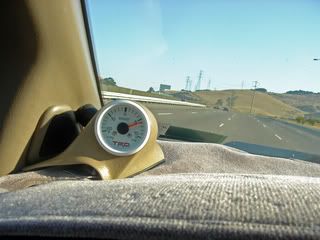

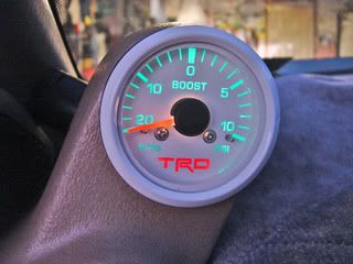

Postby siennasc98 » Tue Sep 12, 2006 10:23 pm
I'm only using a 5.5 psi (2.9" pulley) but the TRD boost guage is registering 6psi (so, the S/C is actually pumping this much).
The freeway was clear so I have the chance to take this picture. No cars in front of me because they are all behind me.
At idle and the lights are on.
