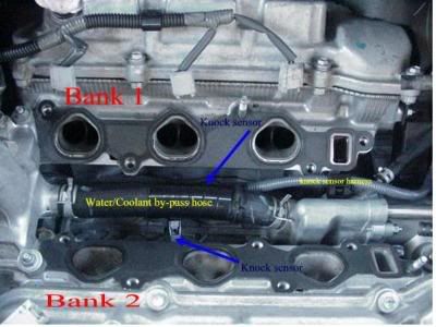

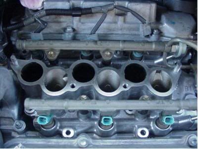

Postby siennasc98 » Tue Jul 25, 2006 6:53 pm
shocar4 wrote:Where is the front knock sensor located? Does anyone have a picture? Thanks.
The intake assembly must be removed to access the two knock sensors. See, next picture.
Removing the by-pass water/coolant hose will expose the two knock sensors.
