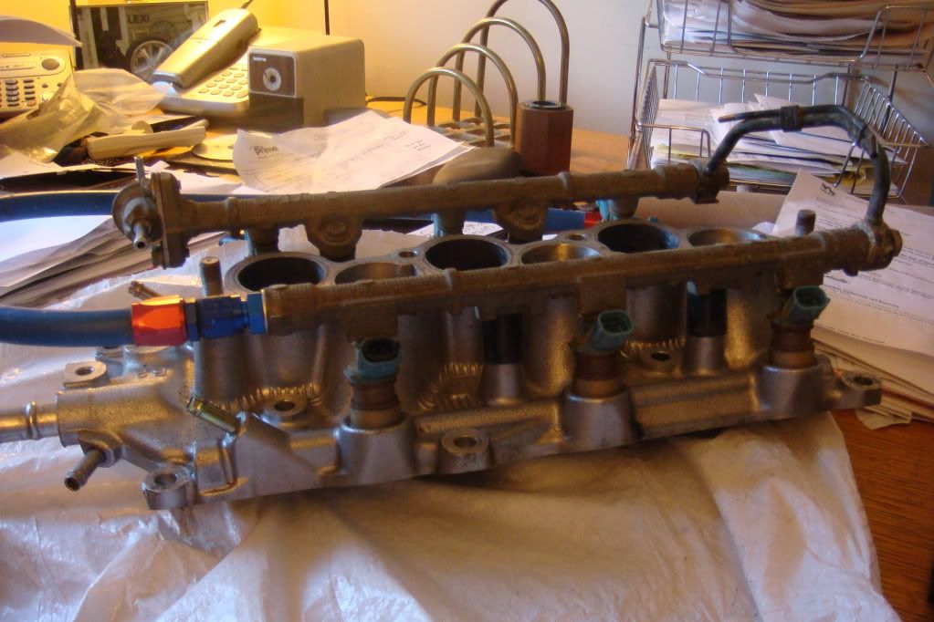

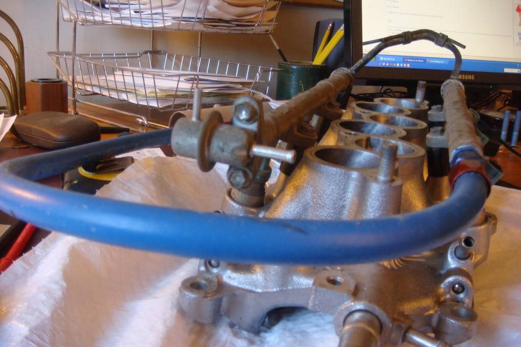

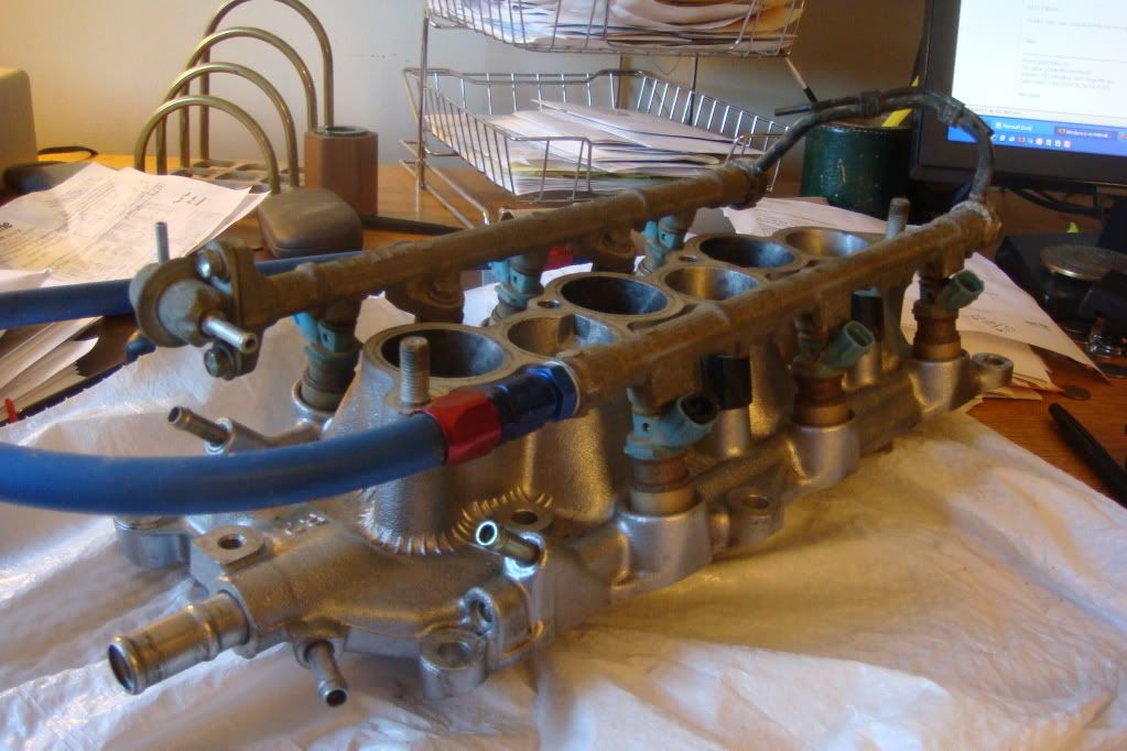

Postby trd4life » Thu Jun 04, 2009 8:00 am
Hey guys, These are pics of a set of Gen 3 1994 Camry V6 return style fuel rails bolted up to my 1999 Solara V6 lower intake manifold. They fit perfect. I also added a -6 feed line as you can see in the pics. I'm gonna try to source a few more sets of these to sell on the forums so if your interested PM me.
I'll be using this setup on solara for the M90 supercharger kit, with the biggest advantage being i can hook up a rising rate fuel pressure regulator on the return line if i need more fuel .

Postby trdkamuri51o » Thu Jun 04, 2009 8:51 am
finally a possible solution for fuel shortages without having to do extra upgrades

Postby ASG14 » Thu Jun 04, 2009 9:09 am
trdkamuri51o wrote:finally a possible solution for fuel shortages without having to do extra upgrades
You still need to upgrade stuff. Still need the custom fuel line and filter. Still need the line to run to the gas tank.

Postby Mole » Thu Jun 04, 2009 9:09 am
is there enough pressure?

Postby ASG14 » Thu Jun 04, 2009 9:14 am
^ It essentially turns the Gen 4 into a Gen 3 fuel setup, which means you can run the 255 Walbro pump for more pressure.
