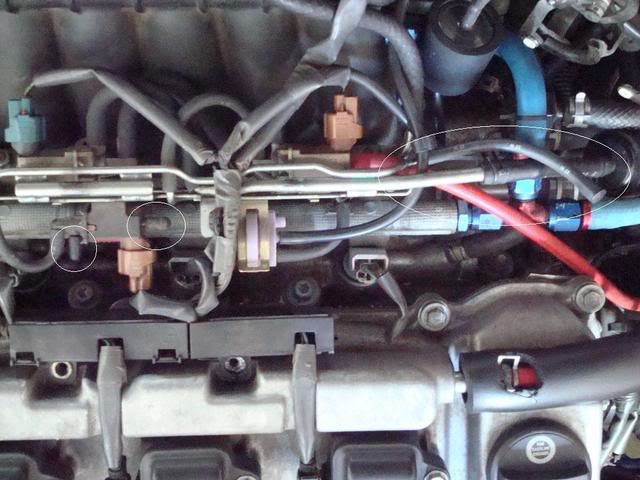

Postby Dawgz » Sun Jul 08, 2007 9:20 pm
i noticed something when astro posted his vaccume hose hook up,
u see where the Vaccume tank hoses are capped off? mine are not, they are setup like factory, they go to the vaccume tank and wat not.
Is that a problem?
Postby Astro » Mon Jul 09, 2007 9:00 am
^^Yeah, i capped it off. Whenever I use the vaccum tank it just doesn't act right. But, when I cap it off it works fine :-? Try it that way and see if it makes a difference, I don't know if it'll make a difference for you.
Posts: 4553
Postby Dawgz » Mon Jul 09, 2007 9:28 am
tru, ill do it today after lunch, thanx astro.
Ill come back with feedback.
Postby Dawgz » Mon Jul 09, 2007 1:00 pm
Well, i did the mod, i didnt get to feel much of a diffrence cause i just swapped my 3psi pulley out for my new 4psi pulley... but here are pics of the mod. i used 1/8" vaccume hose caps (yellow).
