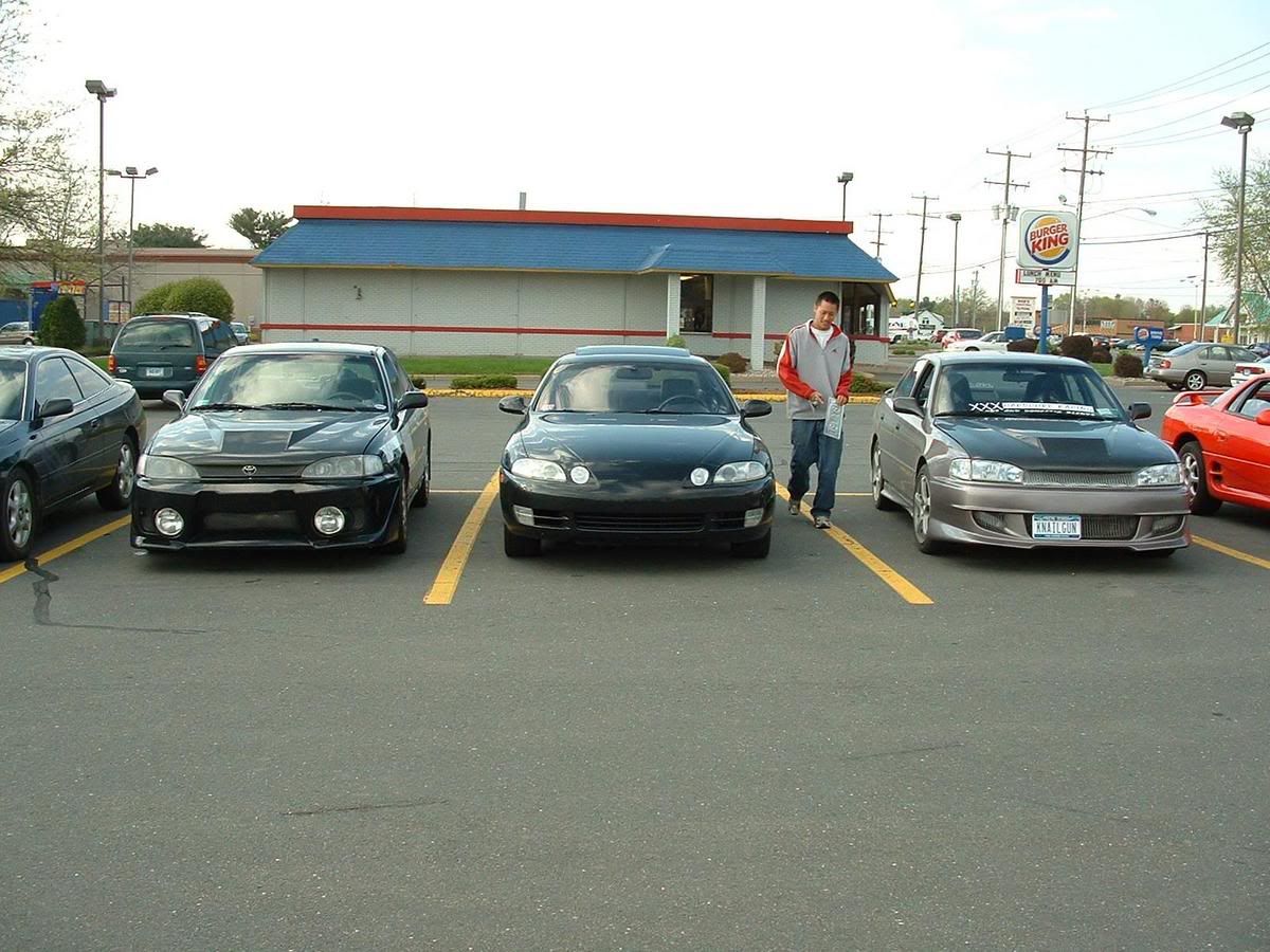

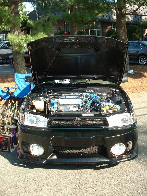

Speaking from soneone who had this kit on their car allready. I'm not sure what to say. I got it for my camry cause it was rare. In a land where everyone had the swift kit and the other one, the evo kit offered an extra set of points in the shows i would compeate in. But there was some real fitment/bodyline issues with it. It does make your bumper stick out about an extra 2 inches forward and it really catches a lot of wind. So when yourdriving with a strong headwind, you have to fight the car sometimes. Also, with it being made of fiberglass, fitment is an issue. Most fiberglass kits that aren't popular tend to be sitting in a warehouse for a while. This causes them to warp and gives the installer a hard time trying to get it to fit. I had to mount metal straps on the sides to pull them in, and this made the front middle bow. It also lowered the front of the car several inches and i was constantly scaping (with stock springs). These are a few things to consider when ordering a kit. I know it looks cool, but you need to think long term as something like this will most likely require more maintenence than the factory setup. But it's not all bad, those fog lights really light things up nice.
I've included a few picstogive you a "real world" idea of what it's gonna look like on a similar car.
