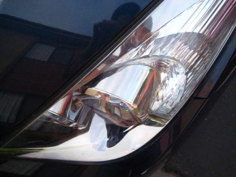

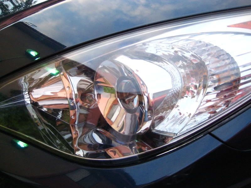

Postby LostSoul » Mon May 26, 2008 7:57 pm
i used that plastx you think i did a job?
LostSoul
Posts: 449
Location: NoHo,818
Postby gnegroni » Mon May 26, 2008 8:00 pm
It looks great! However, if YOU are not satisfied... just do some more with an orbital polisher.
If you think they can look better, THEY CAN! Just don't overheat the headlights in the process.
