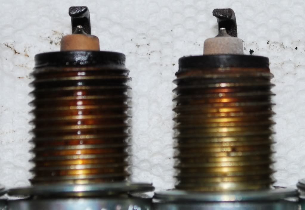

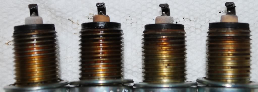

Postby gnegroni » Mon May 04, 2009 5:39 pm
Alright, I changed the plugs (4 months later) after doing the whole Seafoam treatment (oil, tank and vacuum). Everything went fine but I ended with two questions after finishing procedure:
1) Don't our cars come with Denso plugs as OEM. Mine had NGK IFR6A-11
2) Whats wrong with these pictures (plug order: left->right, accessories->air filter assy)?

Postby Aotoyota » Mon May 04, 2009 6:59 pm
I dont remember mine having the greasy oily looking stuff on the thread?

Postby gnegroni » Mon May 04, 2009 9:07 pm
Aotoyota wrote:I dont remember mine having the greasy oily looking stuff on the thread?
I take it this is probably due to the SeaFoam cleaning prior to changing them...I take it that is the reason why SeaFoaming is recommend prior to making a plug change, not after.
The plugs fired fine, but if they look like this at 70k miles, I can't imagine how they will be when replaced by-the-book at 120k miles.
Please also note the aggressive ground electrode degradation and coloring on the ceramic center. I'm perplexed.

Postby Aotoyota » Mon May 04, 2009 10:22 pm
Check the gap if they are out? might be something too it?
I know Iridium plugs dont need it but since you have them out.
check it out?

Postby System_Crash » Tue May 05, 2009 10:41 am
Well my car had 84000 on it and they looked like this http://solaraguy.com/viewtopic.php?t=44431
notice the red ceramic (probly from all the intake/injector cleaner I've run through it)
