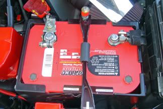

Postby siennasc98 » Sun Sep 03, 2006 6:39 pm
woa_its_j3ff wrote:I'd go with Red Top, or even blue top. I've seen an Orange Top but I'm not sure what it's for, my friend has a Red Top and I have it as well, it's really great on both our cars..
I have the Red Top SC34R. Installed it 3-years ago.
The Optima Orange (color) top was discountinued and it's now Red top, with the reversed poles.
CA: 1000
CCA: 800
RC: 110
siennasc98
Posts: 195
Location: 707 - Vallejo, CA
