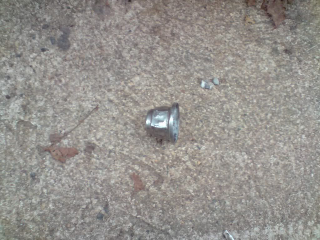

Postby KSolara » Mon Nov 23, 2009 1:47 pm
finally got some pics
theres one with the cover and one without
and here is just the plastic part
and i found out the size of our nuts 12 by 1.5

Postby kingkakyle » Mon Nov 23, 2009 1:57 pm
i think cuz hes got them 16s instead of 17s
ummmm cant help u there really cuz my lugs from my 17s were all metal
u can go to a tire shop and they should be able to sell u sets of new ones
Postby unbalancedwood » Mon Nov 23, 2009 3:55 pm
Glue...they are just for looks & thats how they are put on from the factory.

Postby KSolara » Mon Nov 23, 2009 4:28 pm
I was thinking about that but now the socket doesnt fit over some of them.. they musta gotten Fed up at the shop

Postby 99BlackSandv6 » Mon Nov 23, 2009 4:35 pm
You could get replacement lug nuts from McGard that you can use on your factory wheels. They are solid and have a lifetime finish guarantee. They will run you about $90.
Check out the McGard website, they have a design that will work.
Postby unbalancedwood » Mon Nov 23, 2009 5:57 pm
unbalancedwood wrote:Glue...they are just for looks & thats how they are put on from the factory.
Have you tried a different socket?

Postby Black Bob » Tue Nov 24, 2009 5:53 am
Okay, now I'm getting it. I came across this before in a rental car that picked up a flat. I'm on the side of a freeway in the middle of a rainstorm and those frikken covers had me saying "WTF!" Til this day I can't figure out the logic of putting plastic over a metal on a lugnut. If the size is altered then try using a U.S. socket instead of metric. It's worth getting closed-ended nuts rather than the standard replacement open-ended ones to prevent the nut from permanently attaching to the lug due to rust and dirt.
