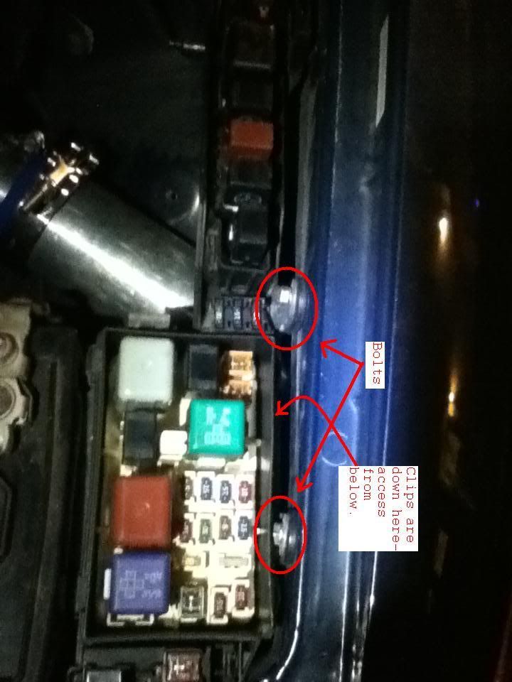

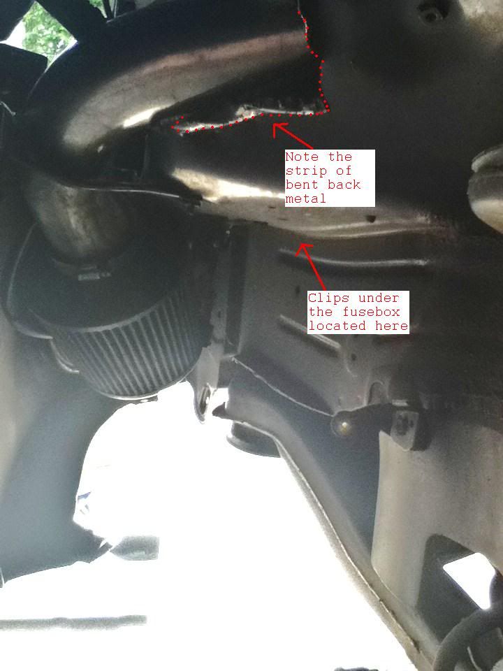

4. Move the fusebox out of the way. This was tough the first time. Take the cover off for better access to the bolts holding the box onto the side of the engine compartment, and remove these 2 bolts. There are also white plastic clips holding it in place underneath the fusebox that you can’t see: reach up behind the fender and find them. Pinch and push up. The fusebox won’t come out thanks to a bunch of wires underneath, but now you can at least push it out of the way.Image

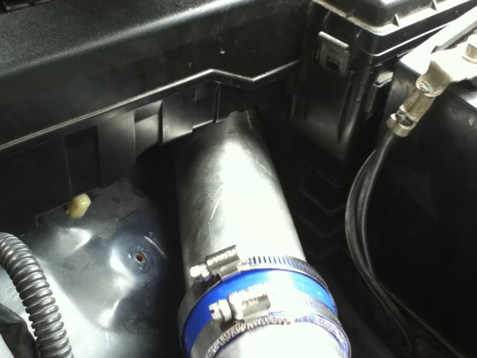

5. If you haven’t already, remove the white box inside the fender that used to be part of the stock intake. If your car is jacked up and the fender lining is off, this should be pretty simple.
6. See that hole where the old intake went? This is where I think most people hit a snag. The hole is not big enough to easily maneuver the extension pipe through. I took some big pliers and bent some of the thin metal back to make the hole wider. If you cut the ends of the stretch of metal you’re bending back, it makes for a cleaner look. Keep bending and trying to fit the pipe until it works. No need to bend back more than you need to.

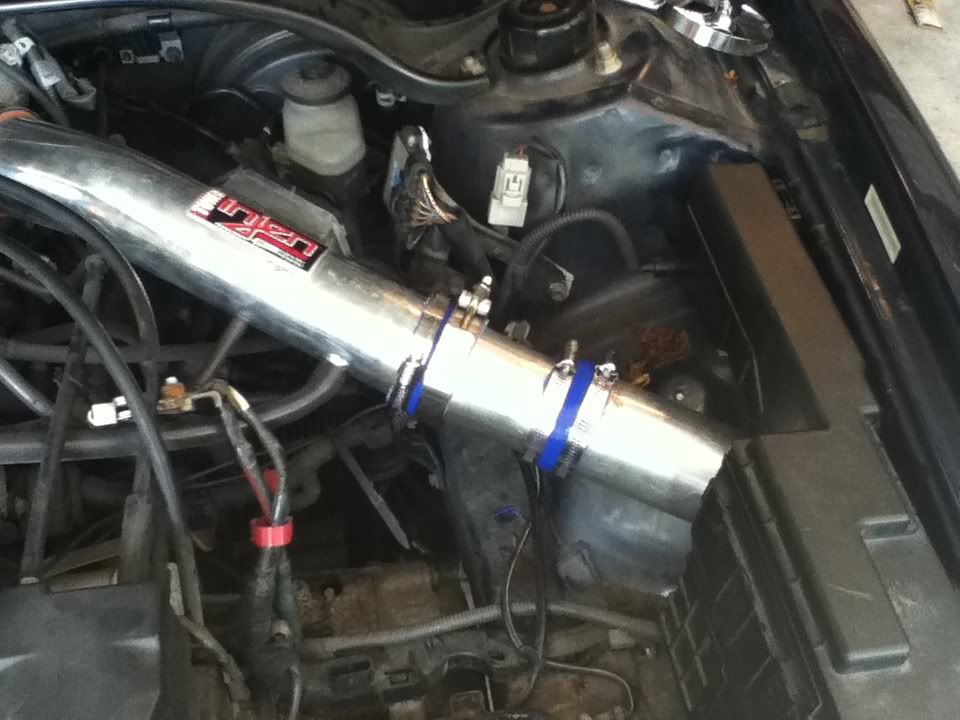

7. If your extension lines up nicely with the end of your SRI, skip this step. This was a second problem some people had: after getting the extension through that hole, there was a gap between the extension and the original SRI (in my case, an injen), like the extension wasn’t long enough. Rather than stretch and wrestle with it or bend more metal back, I got a 3” diameter extension to the extension, about 6” long, give or take. This is also why you need the extra coupling hose.
8. Once one end of the extension is connected to the SRI, go underneath and install the filter on the other end. It’s pretty protected from water here, but if you want extra peace of mind, you can get a fairly inexpensive hydroshield like this: http://www.amazon.com/Injen-Technology-X-1033BLK-Hydro-Shield-Pre-Filter/dp/B001CO2JDY/ref=sr_1_2?ie=UTF8&s=automotive&qid=1304297345&sr=8-2
9. Put everything back together and lower the car off the jacks. I let mine idle for a minute so the computer could adjust to new airflow. I’m not sure that it’s 100% necessary, but I like to be safe. I didn’t feel any noticeable power difference, but I’m sure that will change once July gets here. Enjoy the new sound, too!

Nice write up, one thing is I used a hump hose as my connector between the two pipes and this helps with connection and gives it a little bit of movement if needed.
