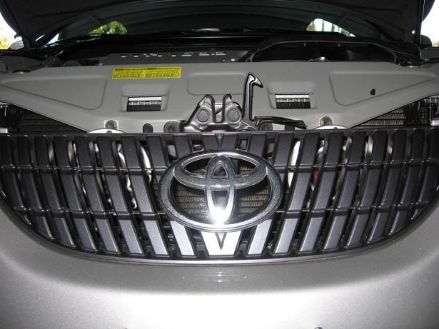

Postby kenny6683 » Thu Dec 10, 2009 12:00 pm
some of you might have seen Subarus with this sitting behind grille
There just horns...but they look cool as hell
as i browse through http://forums.nasioc.com/forums/ which i do every now and then because they have a lot of great mods and ideas(rich spoiled kids)
i found this link for a set of these horns only like $46.00 with shipping
http://www.streetsideauto.com/products2 ... =003399801
Must use Coupon code ssawinner09 (only valid until xmas)
anyways i did a quick edit of my car with these...i dont think this looks as good as it actually would. anyways im ordering a set.

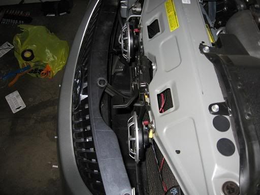

Postby cklinh » Fri Dec 11, 2009 9:14 am
Projex0 wrote:love'em and painted silver(which is starting to flake off)
How was the wiring for these?
cklinh
Posts: 1879
Location: NorCal
Postby kenny6683 » Fri Dec 11, 2009 9:36 am
wiring seems simple...you just need to connect 1 relay. If anyone needs the wiring instructions I can pull them up from the Subaru forum.
kenny6683
Posts: 448
Location: Queens NYC
Postby Projex0 » Fri Dec 11, 2009 5:45 pm
very simple follow the two horn's wiring to where they both meet and connect to a single wire, this will be the trigger that will be connected to your relay.
look up on the relay diagram on what is power, negative etc..
from there just hook up the positive and negative from both horns, to the relay
and one wire goes from the relay to the + side of the battery, the - from the relay can go to any ground on the car.
