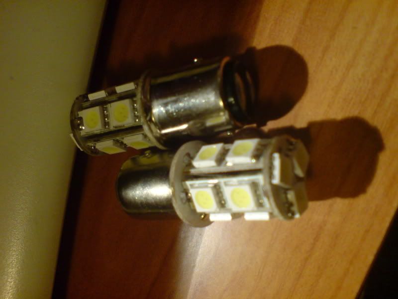

Postby nemoxfishy » Thu Sep 24, 2009 10:35 am
Try SMD/LED bulbs! They're great!
These were the ones I used before, but white turn signals are illegal in my city... Thats y i took them off. Image

Postby Gibson99 » Thu Sep 24, 2009 10:56 am
well if you do go LED, you can use two different color LEDs in the same enclosure to do it. superwhite for parking lights and orange/amber for turns. the problem there is making it flash at normal speed instead of the superfast that LEDs often cause.
