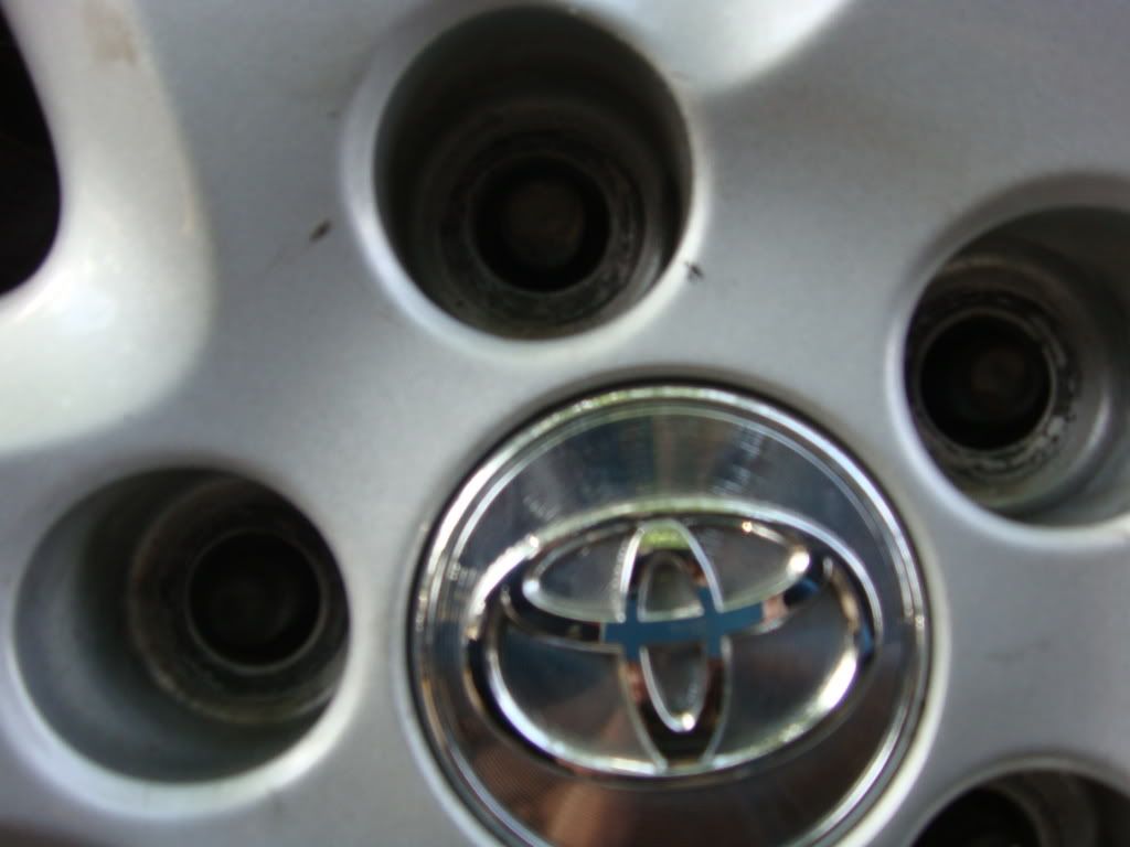

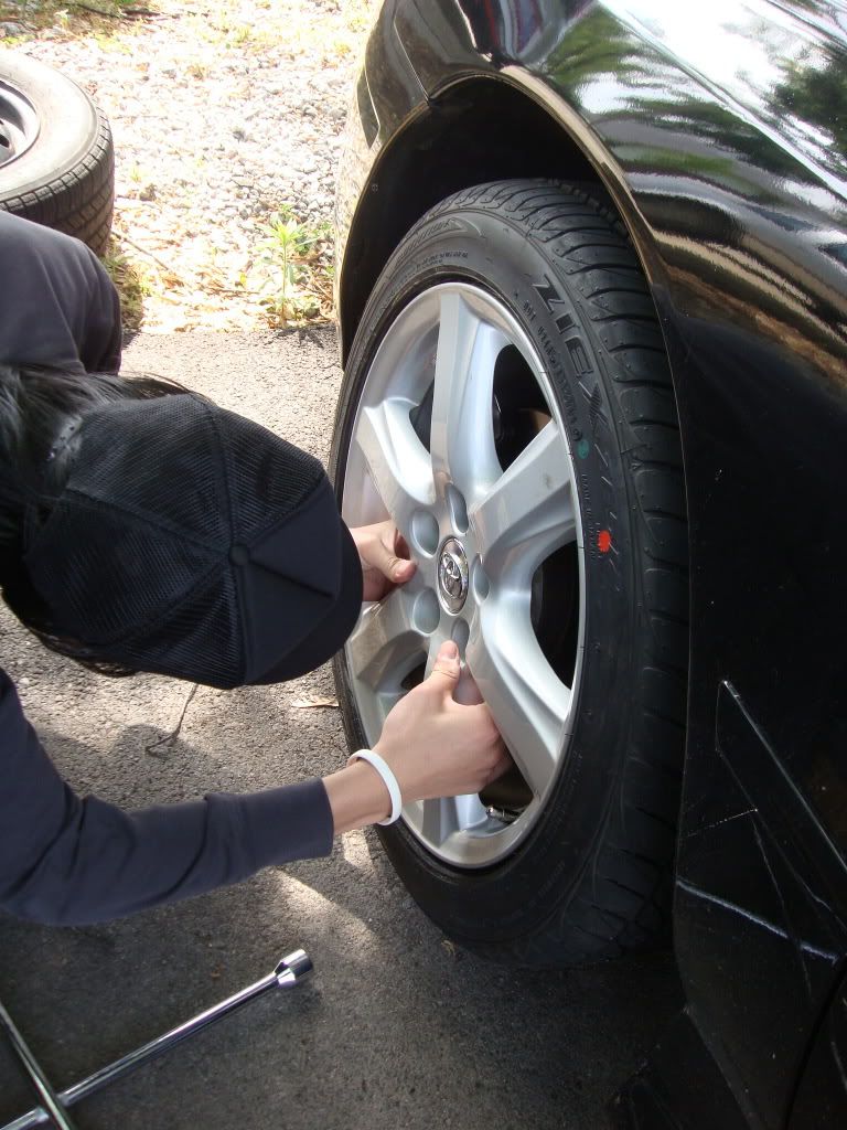

I just bought a set of Camry's wheels few days ago, and i have trouble finding the right lug nuts!!! please help!
Here is the pic of the wheels:
don't know what kind of lug nuts will work for this set of wheels:
I'm thinking about this, would this work????
http://cgi.ebay.com/ebaymotors/ws/eBayI ... 594wt_1825
Thanks.

those look like the right ones to me

You need the OEM toyota lug nuts..

Can't see the link, but it looks like the studs on your car aren't long enough for those wheels. Did you use a spacer?

Another possibility...is there a PREVIOUS hub ring (for an aftermarket wheel) left on the hub itself? That will prevent a TOYOTA wheel from fully mounting onto the hub and the studs won't reach through! I had that happen to me when I tried put on a spare (factory steel wheel) and couldn't mount it because the spacer from my aftermarket wheel was on the left on the HUB (instead of in the aftermarket wheel itself). Toyota wheels do NOT use hub rings!

I had same problem with the isx50 wheels.
U need some oem lug nuts on them.
See if u can get some from a local auto parts store. They might be cheaper than online.. just see what they have and how much.
When i had mine installed at the shop including spacers, i gave them lug nuts but didnt work well so they went to kragen and got a set of 5 for like 6 bucks i think.
Postby akora12 » Fri Jun 05, 2009 5:42 am
PM'd. Basically, you need the longer version of the OEM lugs. Toyota makes a long and short version of the capped nuts. Your ebay link is the shorter version.

Those are the correct lugs..
