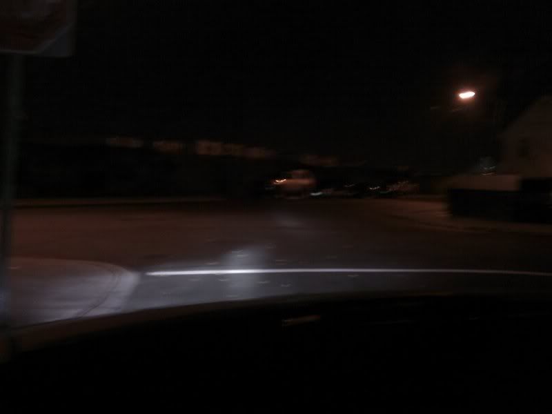

Postby LatinDragonXJC » Wed Nov 12, 2008 7:04 pm
Well I finally got them installed. Thanks for the tips guys, the slit in the grommet made alot of sense.
Now my only issue is the aim. It's horrible, took a quick pic with my phone.
Do I just adjust the bulb?
Was I supposed to remove the OEM light "shield" inside the headlight?
Both openings on the bulbs are facing up.
Here's the pic:
LatinDragonXJC
