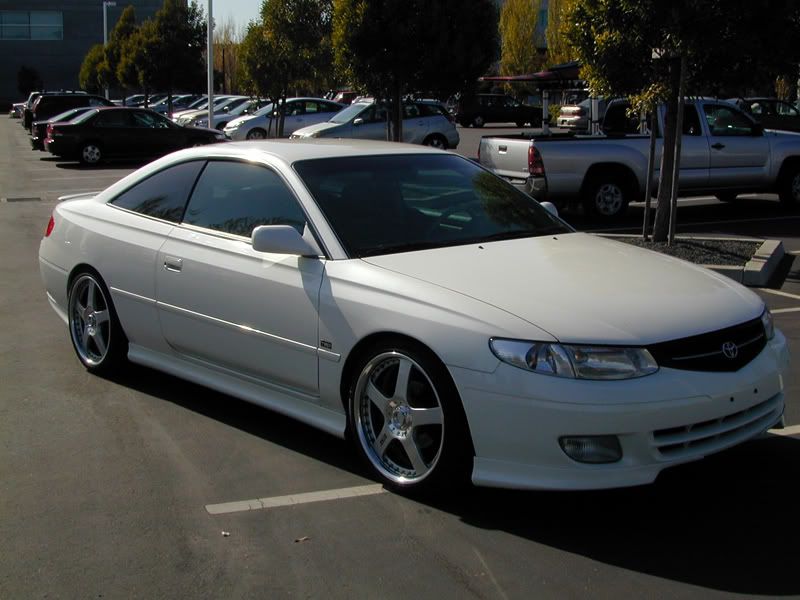

Postby tweazy » Thu Oct 23, 2008 2:04 am
I have the same wheel and tire size but I am using a 1/2 inch custom hubcentric wheel spacers in the rear. I do have coilovers which are thicker than stock struts.

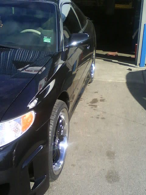

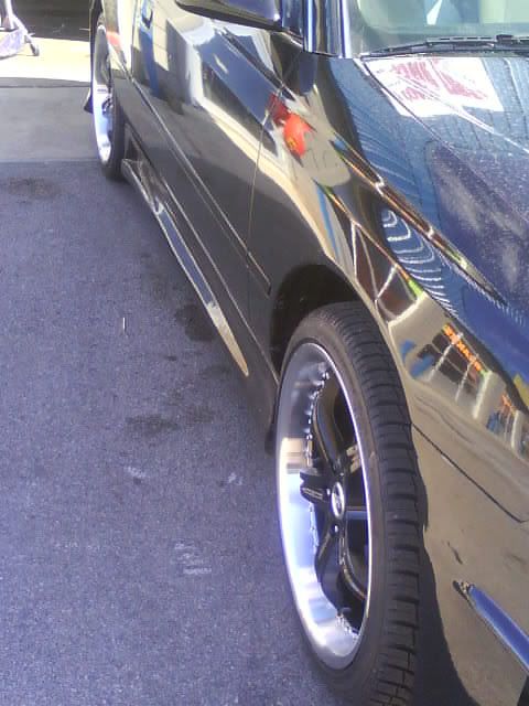

Postby kteng » Tue Oct 28, 2008 9:33 pm
so ya, i did, and it turned out not bad at all.
but i probably need to lower the front a little bit.
sry for the low quality pic.

Postby Akfahad » Wed Oct 29, 2008 6:32 am
^^^those look like Stern's, is that right?
let me know how things go with those if those are...was looking at a set.

Postby CamryOnBronze » Wed Oct 29, 2008 8:11 am
would look 4587934898492 times better with a drop. Lowering just front would not only look weird, but would also be dangerous to the car's handling and performance.
Do yourself a favor and at least get a set of lowering springs. It will make the car look tons better.
