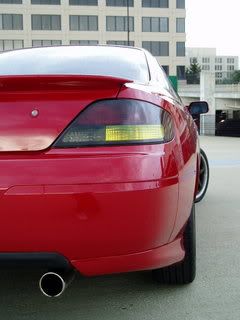

Postby woa_its_j3ff » Sun Feb 24, 2008 8:52 pm
ok well here are mine. a few old pics, but yup.

Postby Ivanhoe » Sun Feb 24, 2008 9:24 pm
woa_its_j3ff wrote:ok well here are mine. a few old pics, but yup.
I can see you went a different route to get yellow fogs......I also really love the rear turns in that color yellow....please tell me how you did both of those mods....thanx!!!

Postby woa_its_j3ff » Sun Feb 24, 2008 9:29 pm
my cars tails are diff now, well same, but different haha..
anyways I did one coat of clear film on the taillight, then cut a strip to the size/match of the turn signal area (yellow), placed it on there, then put a whole sheet of black tint over the entire housing just like I did first time with the clear.
I did this overlaying process cuz vinyl WILL shift on plastic surfaces since of the heat it expands and moves around a lot.. well not a lot but it will move so I overlapped it and put adhesive promotor on the final tint (The black one) and used a hair dryer to seal it all in place. now after 1/2 a year of it bein in the hot summer sun and it being parked outside 24/7.. it's still held up. and in the frigid winter this year, it's still perfect.

Postby Webb26 » Tue Feb 26, 2008 11:00 pm
1st post on solaraguy, lol. Anyways, I was always opposed to doing vinyls but this is one great job. What kind of tint is this(black outer layer that is?

Postby woa_its_j3ff » Tue Feb 26, 2008 11:07 pm
Webb26 wrote:1st post on solaraguy, lol. Anyways, I was always opposed to doing vinyls but this is one great job. What kind of tint is this(black outer layer that is?
picture window tint. the one I have now is like 5%. remember, my old pics show smoked tails. like lets say.. 35% tint.
