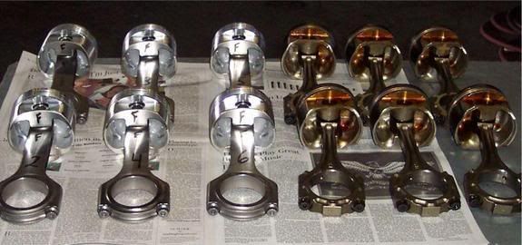

Postby trd4life » Tue Mar 31, 2009 5:57 am
hskrsolara anything over 7psi on stock pistons regardless of whether its a hybrid or not is a disaster waiting to happen. The stock ring lands on the pistons just cant handle the stress. If you want to crank up the boost i suggest doing a set of the 3.3 forged pistons.
piston and rod pics
Postby trd4life » Wed Apr 01, 2009 5:48 am
Arias Pistons and Eagle rods that were used for this recent build (stock pistons and rods on the right)
Postby Eye8Pussies » Wed Apr 01, 2009 9:12 am
those are sexy beyond belief....
