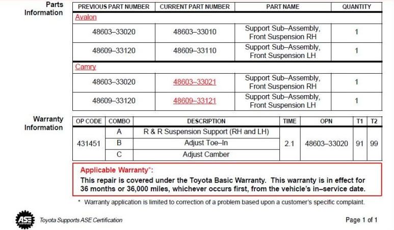

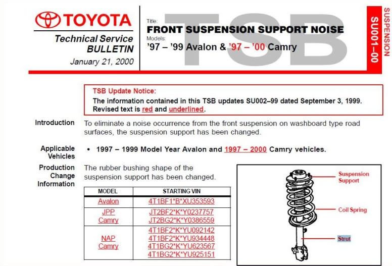

The TRD isolator kit 00602-48700-100 came with both round and oval rubber isolators to fit either of the strut mounts Toyota was using.
Toyota has superseded those original strut mounts to the newer design
(RF) 48603-33021
(LF) 48609-33121
and you will need two strut bearings 90903-63014
Do not use aftermarket mounts they are junk.
I believe the isolator kit came out as a band-aid fix for the TRD struts that is why the kit contained both oval and round isolators depending on which style strut mounts you have. The numbers I gave are for the new and improved mounts.
