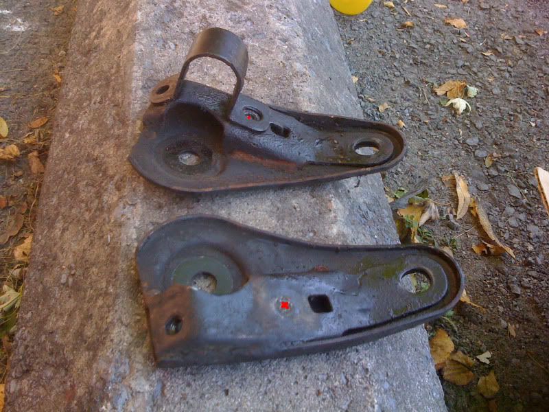

Today I took off the parts between the chassis and bushing in order to extract the bolts, here's a picture.
Didn't have any luck getting the bolts out though. I bought a tap+die set and a T-tool, but didn't get an easy-out, and I'm too nervous about the situation getting worse =/ I drilled a hole on the other side of the bracket and tried to reverse the bolt but no luck. I think I'll bite the bullet and bring these guys into a mechanic and pay the $10-$20 for the extractions. I miss driving my car =(

Postby SleeperSolara » Wed Sep 09, 2009 10:34 pm
Inverted wrote:Today I took off the parts between the chassis and bushing in order to extract the bolts, here's a picture.
You could go to the salvage yard and pull that piece off. *shrugs*

Postby Inverted » Thu Sep 10, 2009 12:41 pm
Paid my mechanic to extract them, 1 came out easy, the 2nd had to weld a new nut on it, only $20CDN, not bad. Here's hoping for tonight's install!

Postby Inverted » Sat Sep 12, 2009 4:16 pm
Well the install failed after bolt extraction. The mechanic's weld for the new nut didn't hold. Lucky for me I went to my dad's this morning, re-welded the nut, everything went perfect, then installed no sweat! Put the end-link boots back into place with a little effort and cursing but now it's all good!
